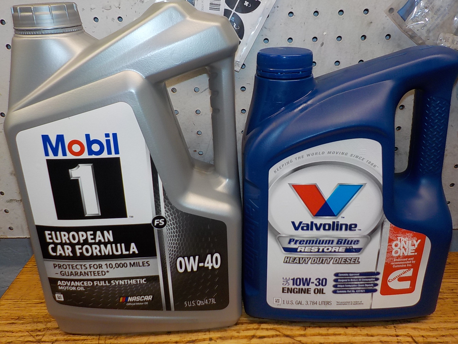

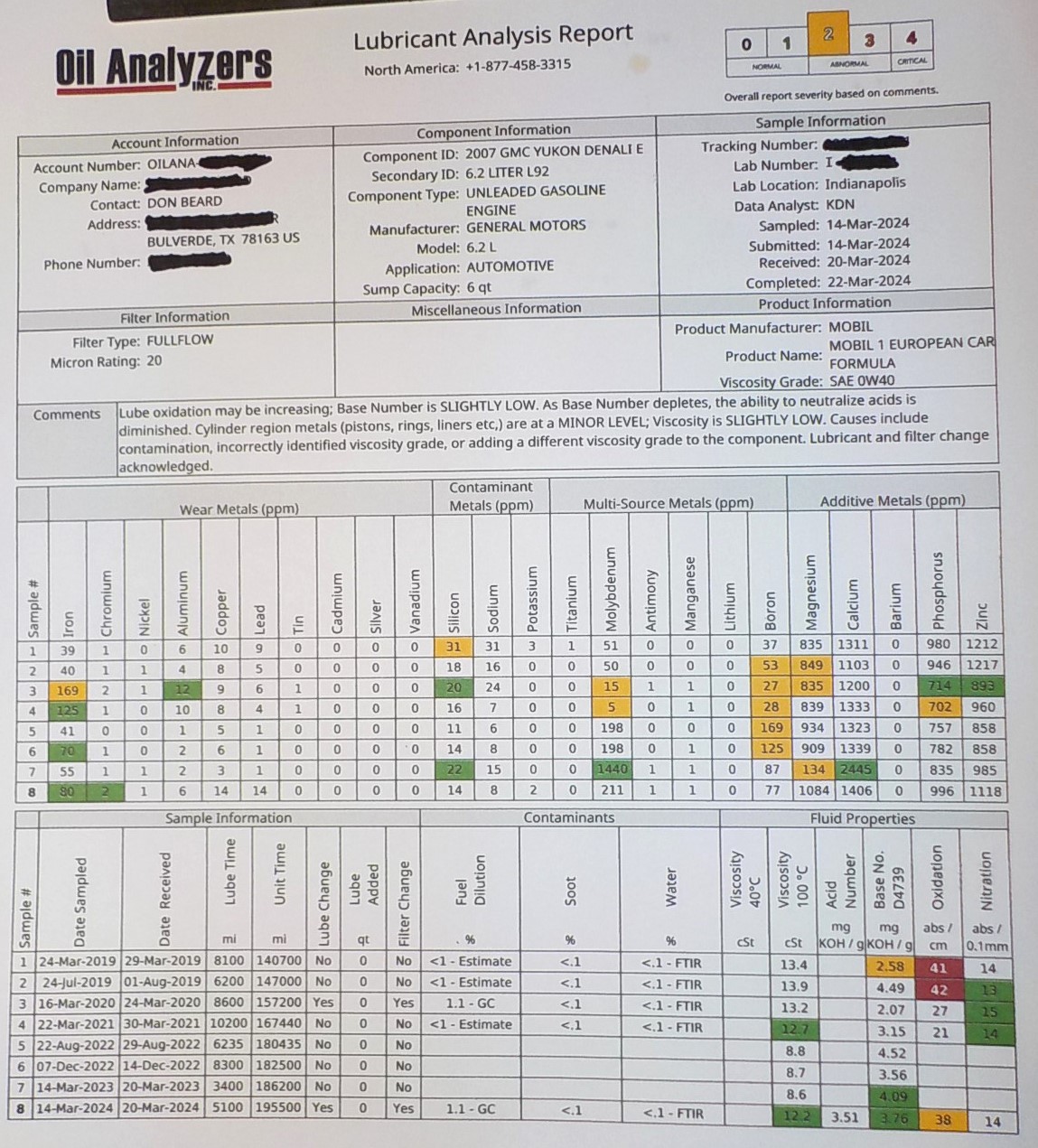

Oil & Filter had 5100 miles. OLM = 51% remaining.
07 Denali w/6.2L L92 w/195k miles
Use is 70% hwy (18+ mpg) and 30% local/rural (15 mpg)
Oil was a mix of the two (see pic).
Engine didn't need any makeup.
Catch can caught 2 ounces in this 5k mile oil change interval.

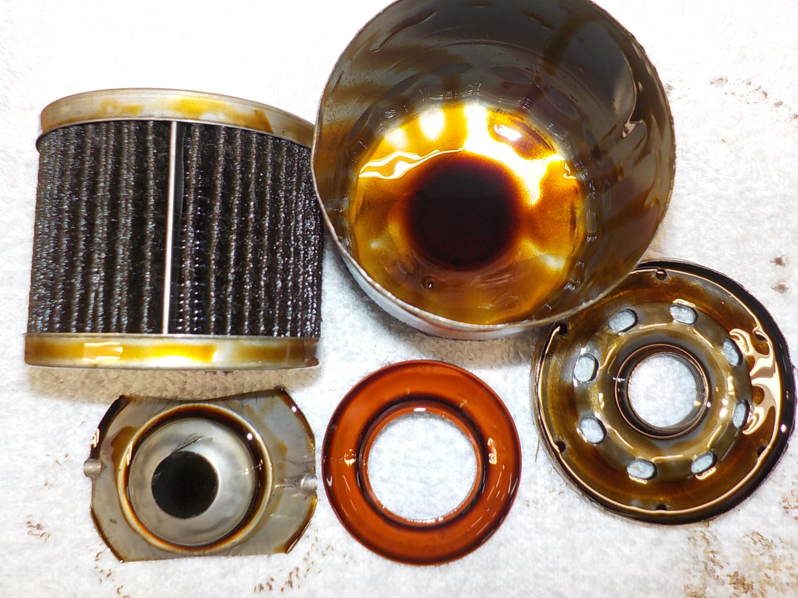

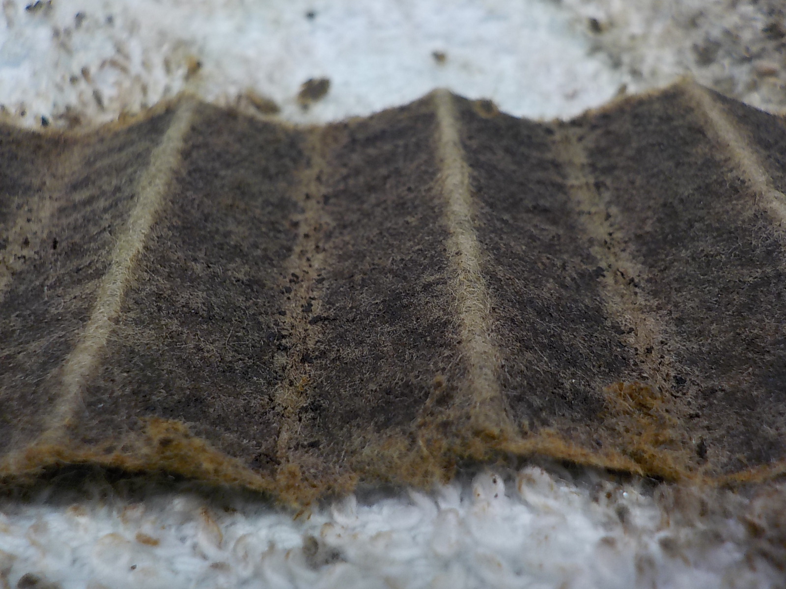

Filter has some carbon in the bottom of the pleats.
The Valvoline "RESTORE" oil is no longer available but I have a stash of it. Its designed to "CLEAN". The insides of this ole engine needs cleaning. It had been road hard and hungup wet before I bought it 65K miles ago.

Yea, there’s some scrubbing bubble action going on in there. I imagine the oil analysis companies will get a lot more business as electric cars roll in.

finally someone looks at an oil filter media without it being covered in oil still lol. I tell people all the time just lay it on the pig mat, it will suck it dry in no time, then pull it tight and you can see every speck.

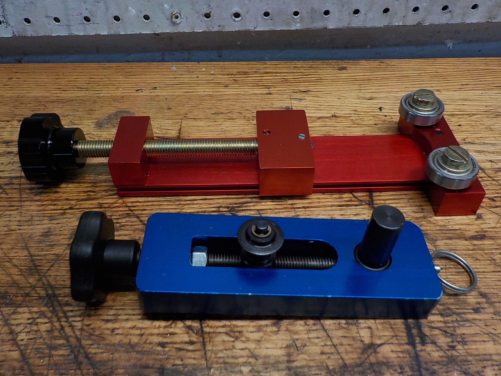

Yes I squeeze the excess oil out in a vice, takes 5 mins
