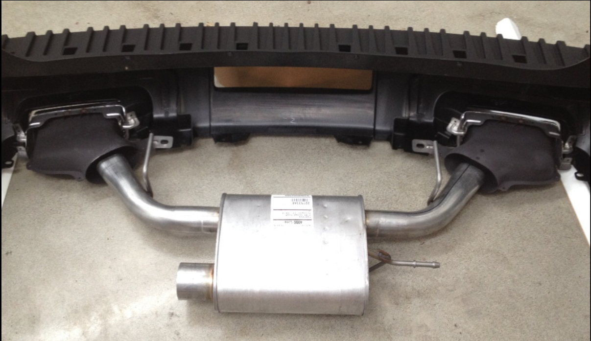

I recently scored a SWB dual exhaust bumper cover for $200. While preparing it for paint, I noticed there are no attachment points for the exhaust sleeves. Is there a specific bracket that connects the sleeves to the bumper cover?
I have everything except the hitch cover and sleeves. I envisioned attachment points molded into the cover for connecting the sleeves. Used sleeves on eBay seem to be attached either by screws or melted into the bumper cover, just curious how theyre being attached. I won't be purchasing sleeves soon since I already have new SS quad tips from the dual axle back kit I installed over the summer.If you’re talking about the 12-14 Esky Premium OEM valence Nate Dog nailed it here.

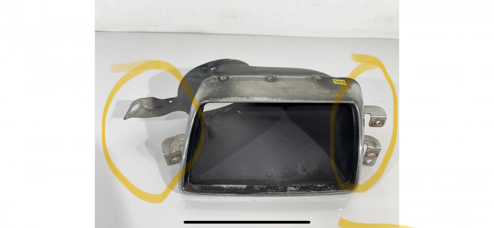

They call them “exhaust sleeves” but they have mounting points on themSleeves? Couplings or exhaust tube connectors?

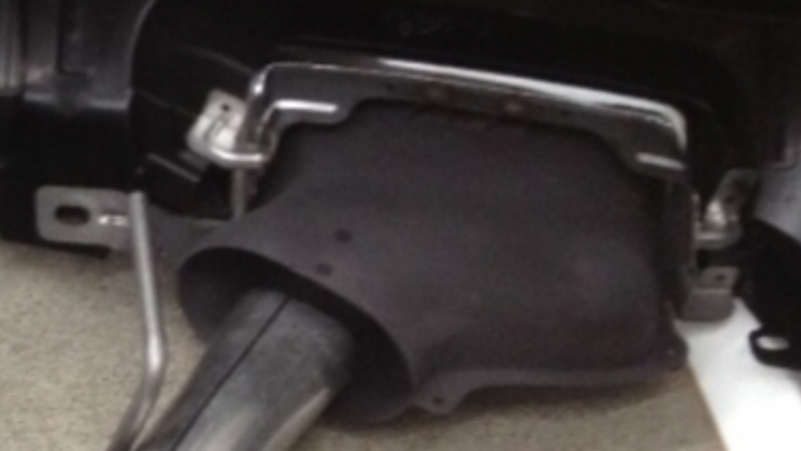

It looks like there’s a black plastic bracket between the bumper cover and the exhaust sleeves. The hunt continues…Ok, gotcha. Here ya go …
Installation pic's for my 2011 Escalade with...
