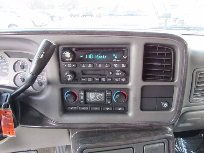

Not sure where you're located, or if it's even worth it, but I'm going to be pulling all of that out of my 03 Denali. You are welcome to have mine if you want to come get it, or pay for shipping. I'm in Oklahoma City. It will be a couple weeks before I do it. [email protected]

Just to clarify, are you talking about this unit? Or the actual head unit? I will send either, or both but I want to confirm it actually works before you spend money to ship it. I've only had the truck a few days so I don't know yet whether it works or not.

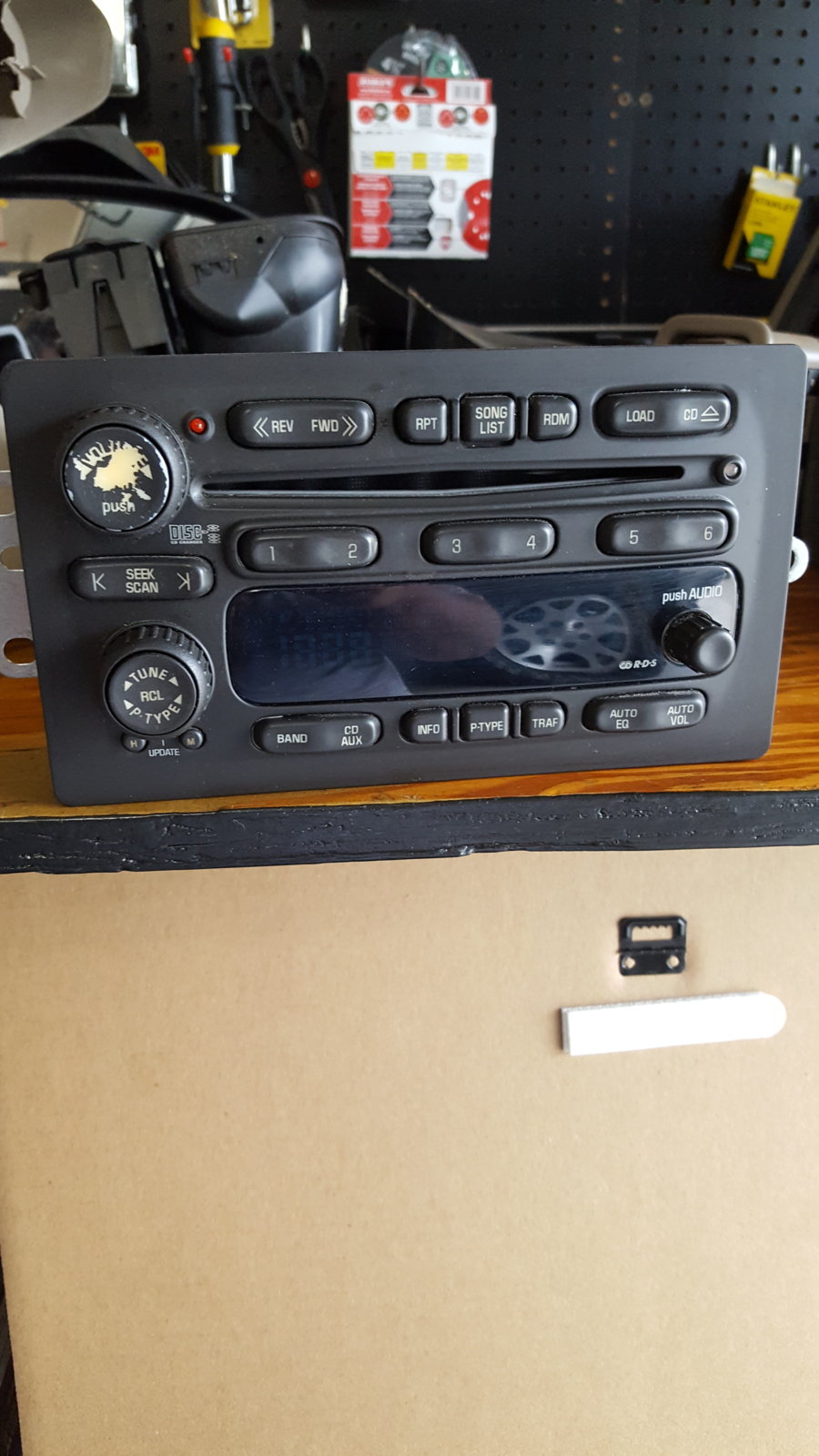

I forgot the Denali has a different stereo system. On mine, the 6 disc is in the head unit. Do you have a picture of the head unit too?
Wondering if I could make that system work in place of my factory Bose system with 6 disc head unit. Thanks again.

Here's the head unit. It's a little rough. It works for am/fm/sat but I haven't tried the cd or tape, but i can try the cd part tonight..
