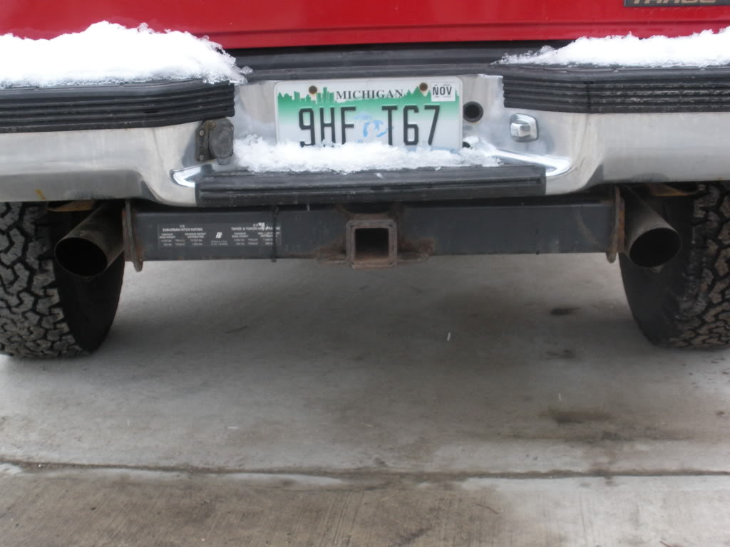

Yeah I would check along the frame rail. Who knows, the tow package may have never been used. I converted mine to a 7 pin round by taking out the license plate light on the left side of the bumper and widening it with a Dremel tool. It looks really nice, we even did it to my dad's suburban because his was ghetto rigged to the hitch itself when we bought it.

This is the best picture I have on the computer right now. This is with the old hook up, I replaced it this summer with a brand new one. I will try to get some better ones on here tomorrow when I get home.

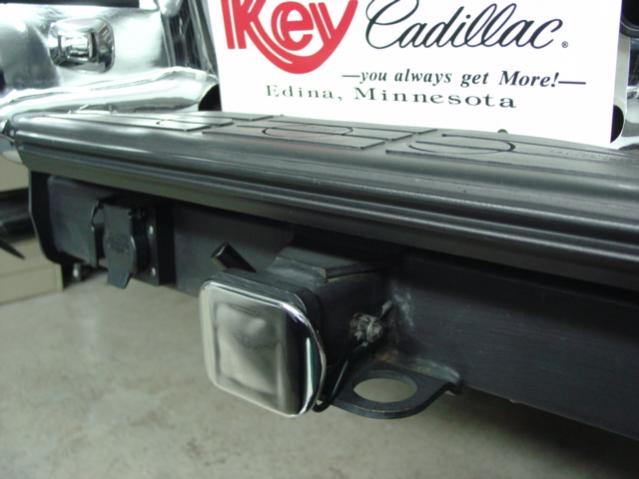

You can drill a hole in the tow bar and install a plug. I used the combo plug for the seven pin and four pin. To hook it to the wiring harness, I used the adapter "T" that plugs into the trucks wiring harness.
Most places that have supplies for trailers should have the plug and adapter.
I used a hole saw on the front and a smaller hole saw on the back for the wiring harness. :)
