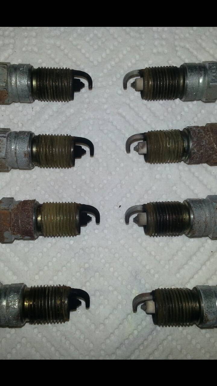

Well the rough idle came back soon after my last post so I changed out my plugs and wires and then took it for a little drive. The rough idle is still there. I am going to fill up tomorrow with some injector cleaner because I already have it and it couldn't hurt. When I changed the plugs I noticed a pattern, the four on the drivers side were black and the four on the passenger side were white. Any thoughts on this?

Here's a picture of the plugs
Sent from my SCH-I535 using Tapatalk

after talking to some people at work and showing them a picture of the plugs and they said the intake gasket is probably leaking. One of them has had the same issue and that was the problem. so i guess that is the next thing to look at, they said to check it spray some brake cleaner around the intake gasket seal and it will start idling really rough indicating there is a leak in the gasket letting in more air creating a leaner mixture.
