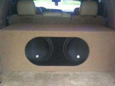

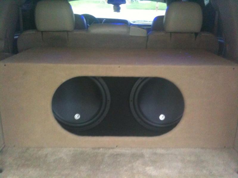

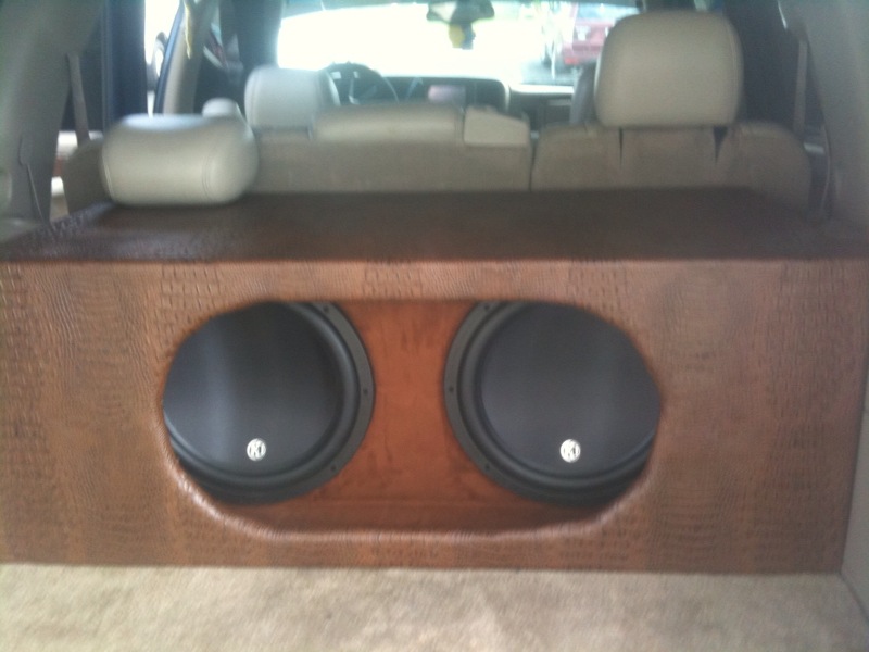

started addin gator to my 03 tahoe still in the works all done by myself and a friend let me know what you think and any ideas.

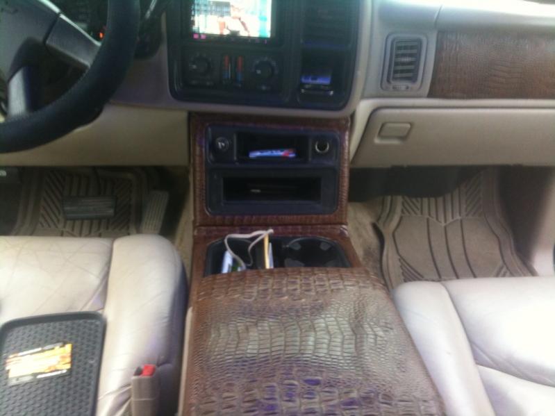

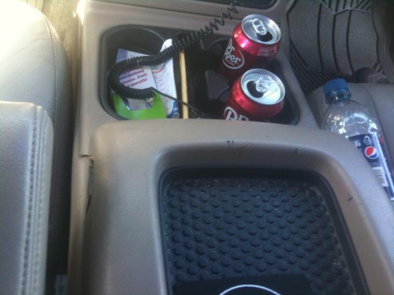

center console
i removed the lid then bought some foam and just cut a layer at a time and glued to the inside then wrapped the top tucking the bottom under the lid. hardest part is the corners.

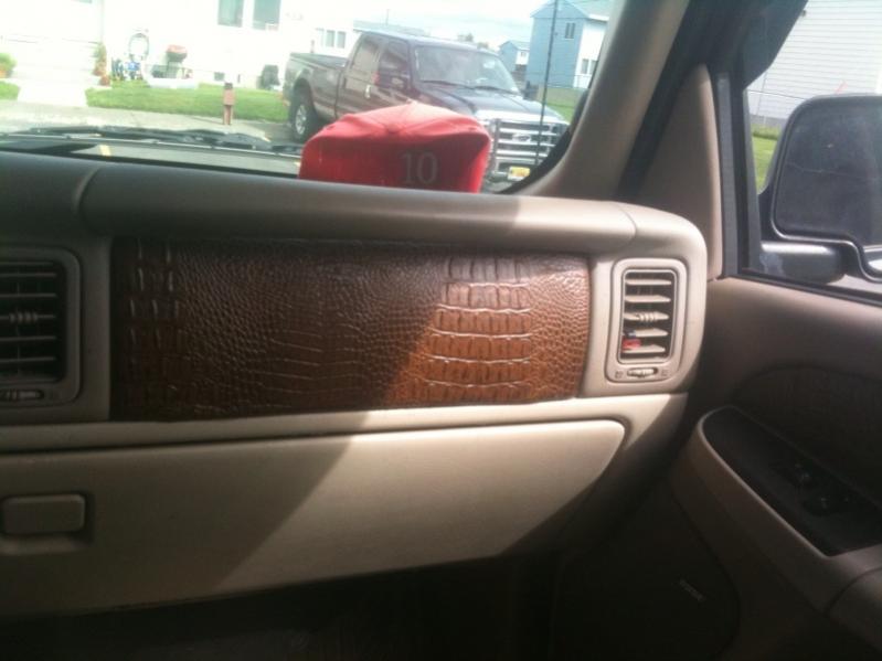

Ok how do you remove the air bag cover

Airbag
To remove the airbag undo negative terminal drop glove box down qnd there is 2 screws then pop out the two airvents and there are screws back there kinda hard to get to after that jus work it out and disconnect harness n bag
