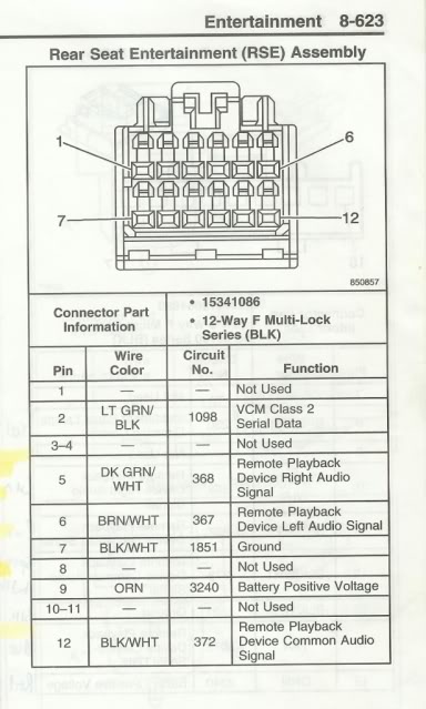

Wiring it up was really easy. I found a diagram (through a user on another forum) of the stock wires coming from the headliner (I'll post it below). I just tapped into the battery and ground wires for power. I did have to run a wire back to the fuse panel for switched ACC (ignition) power. That was really easy though as I didn't have to pull the headliner. I just fished it over to the drivers side plastic panel by the windshield and then down to the fuse panel.
