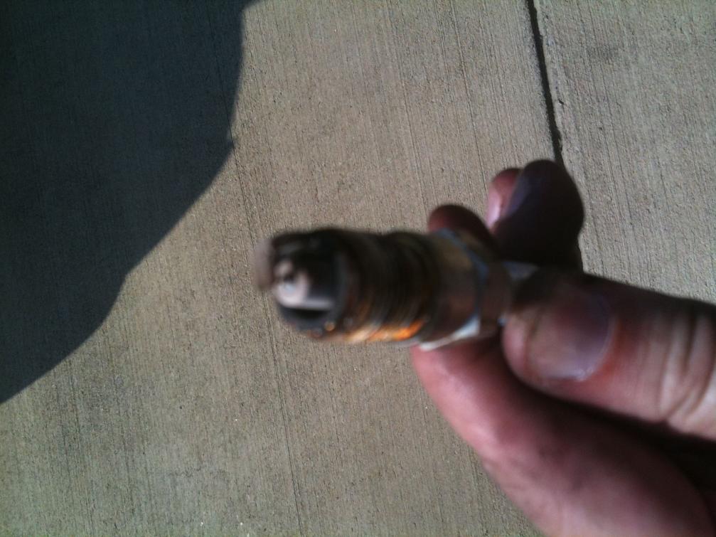

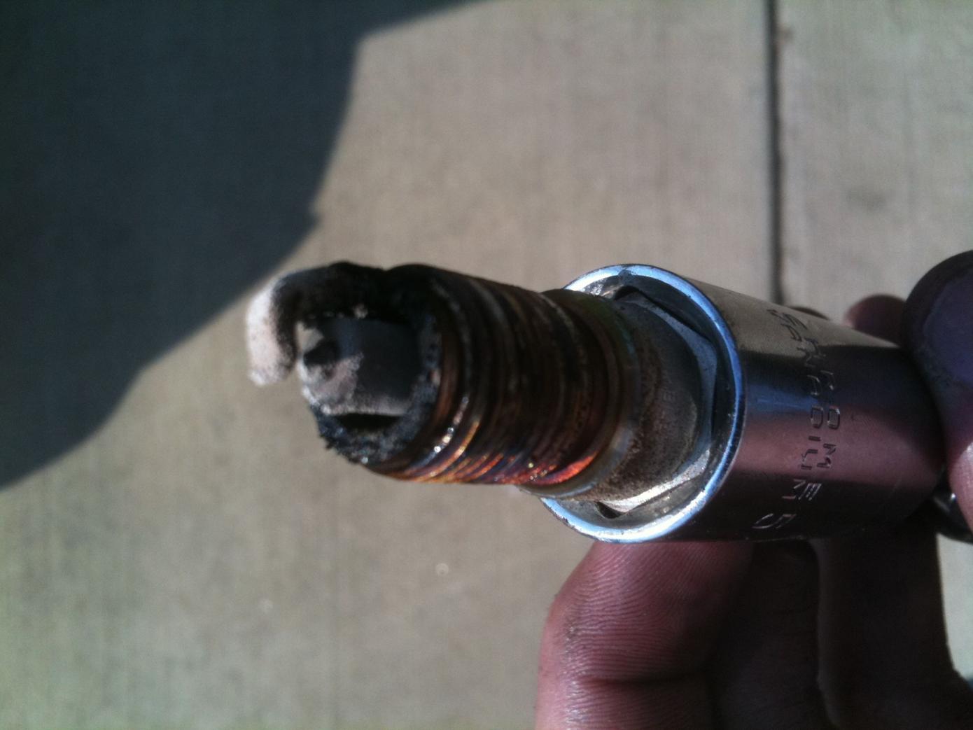

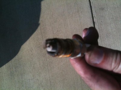

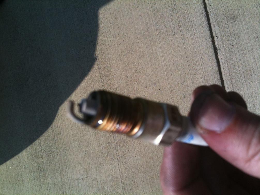

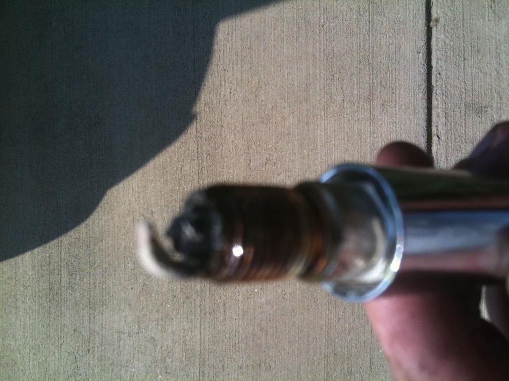

So I cleaned the throttle body, replace plugs and wires, and lubed the body and door mounts with PB Blaster. I used Autolite wires and AC Delco iridium plugs. I was kind of surprised at the difference between the condition of the plugs. Here is a few pics of the best and worst one. I assume they were original plugs with 94k on them. I'm looking forward to seeing how much better the idling is and if I get a bump in MPG.
I got the "low oil" message today and I added about 1/2 quart. I hoping this is a normal thing. This is oil that was in it from the dealer when I purchased it so I hope to have a better handle on it when I change the oil with Mobile 1 synthetic and filter next time. Also I got a quote from a local auto shop so I'll be getting all the fluids changed soon.
