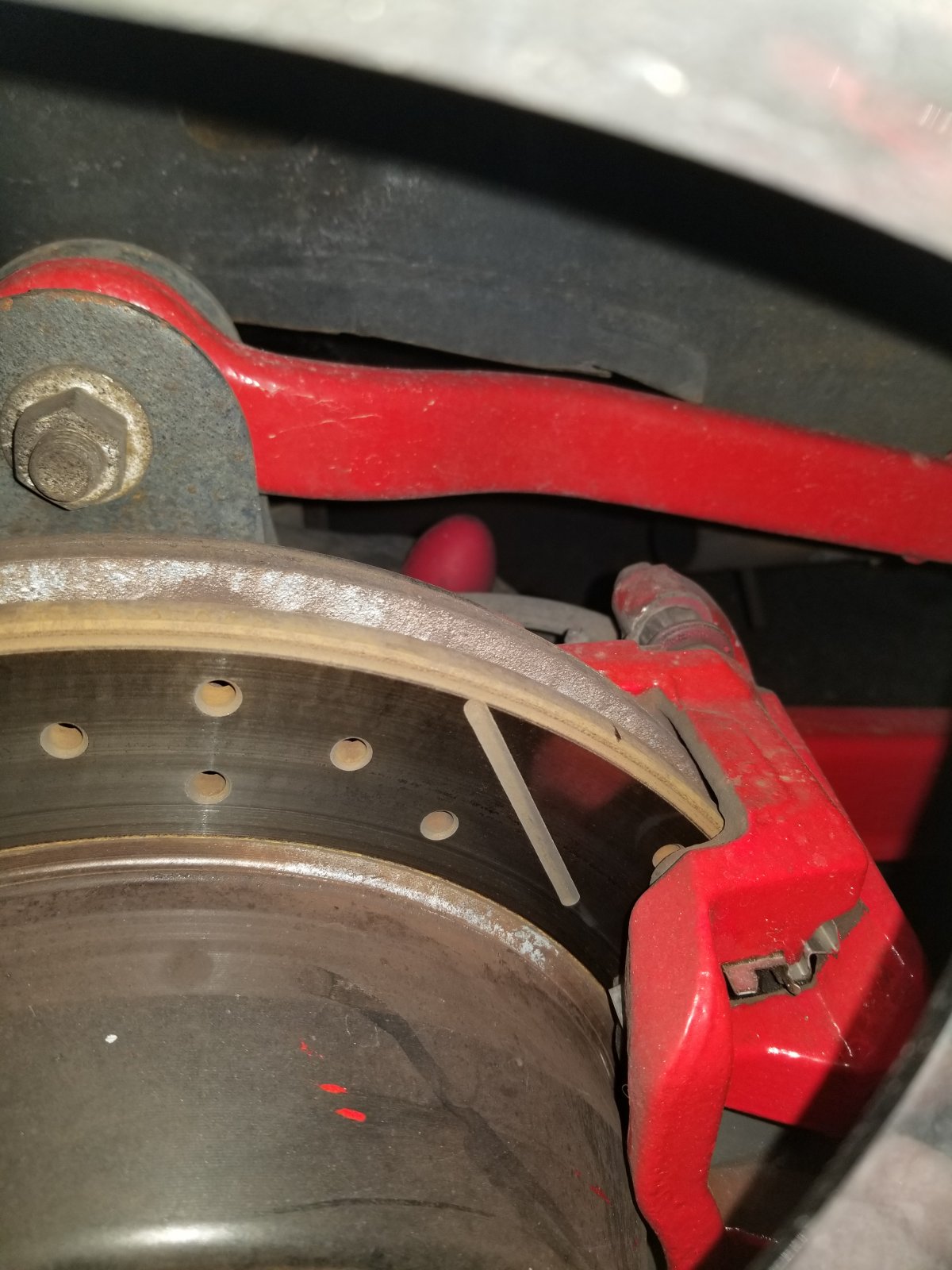

Here's how I did my 04. Just a energy suspension bump stop off Ebay there is a pad at the bottom where the old one hits. I just got a right angle drill. Drilled an tapped a hole an screwed it in20190317_203804.jpg
