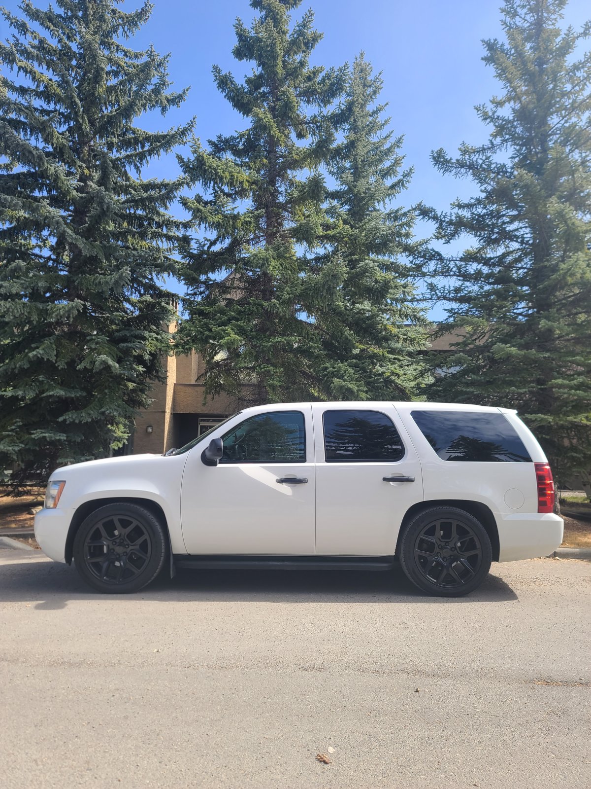

Freshly lowered 2014 PPV w/pics. Way to center rear wheels?

The only way to get it any better than the DJM relocators is to buy the Spohn adjustable arms to replace all 4 rear control arms. I would imagine you'd need a way to check the pinion angle and probably have to adjust the arms on an alignment rack to make sure the rear end in aligned properly.

Those are a nice bit of kit maybe a little pricey for my budget right now. If I decide to keep this thing for more than a few years, might have invest in those. Thanks for the info!

I don’t think anybody is going to notice that but you. So I wouldn’t sweat it too much. It looks got btw. What size tires are you running?

ALSO CURIOUS ON TIRE SIZE.
ARE YOU USING FACOTRY COIL SPRING IN FRONT? I JUST DID A 3/5 MCGAUGHYS KIT AND MY FRONT IS WAY TOO LOW...
