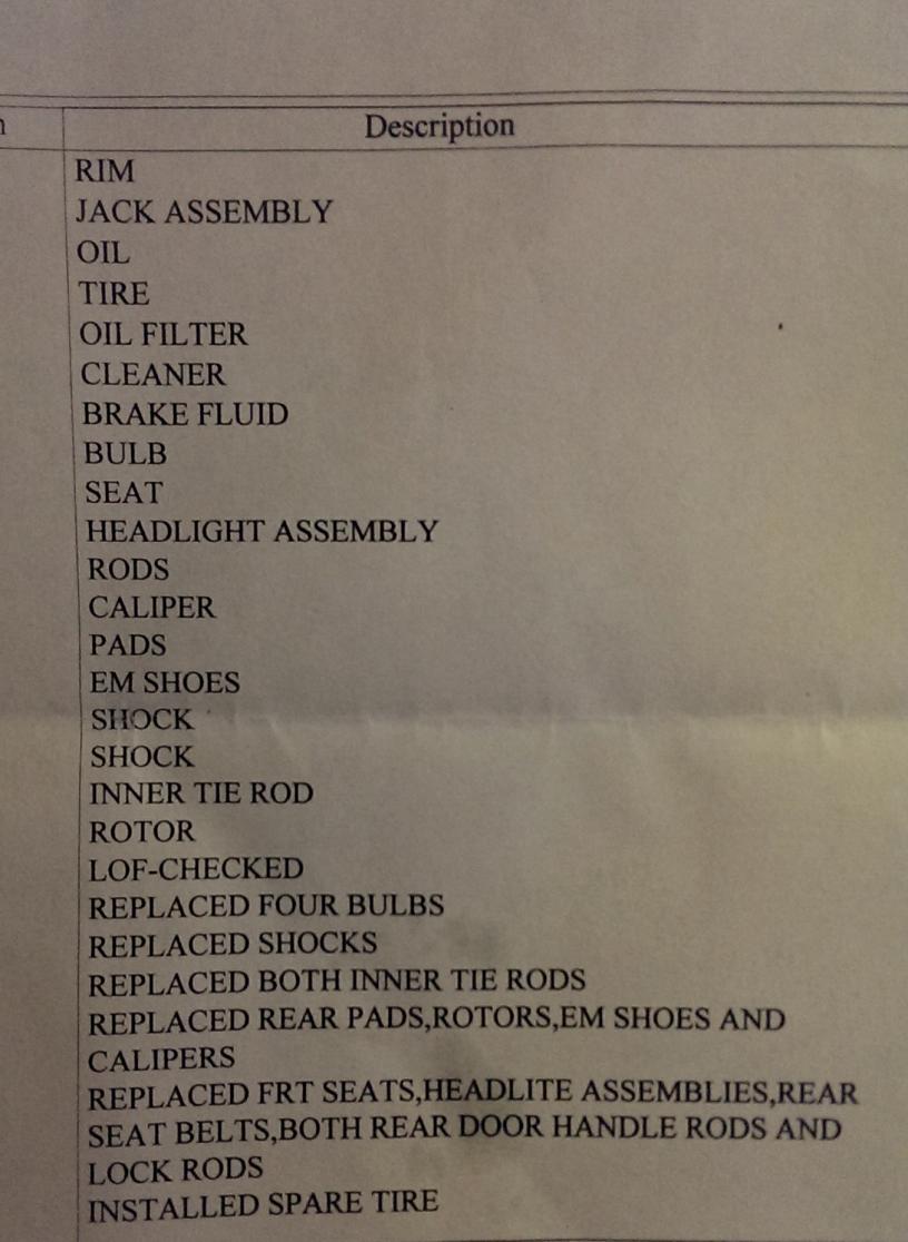

it is 4x4, It has new shocks on it that are just stock shocks from what I can tell. It drives around town fine, there just seems to be something "off" in the steering of the truck. I will prolly have to take it to the garage in town and have em do a once over on it. I really love the truck and am glad I found this forum cause there is a ton of really great mods for these vehicles and looks like a wealth of knowledge to be found here. I attached a pic of the list the seller gave me of parts that were replaced on the tahoe before I bought it. One thing that really surprises me is how easy the steering is for such a big vehicle. As far how easy the steering wheel turns.

Im not sure how old the tires are, they are Michelins but they do show some signs of dry rot on the sides.
Given your list of repairs recently performed, I would start by suspecting the tires. The tires are stamped with date codes, you can figure out how old they are, but any dry rot on the sidewall is really bad. If all the parts on your list were actually recently replaced, but it has older dry rotted tires, well that seems a little backwards to me. There are some good lower priced tires options I can recommend.
