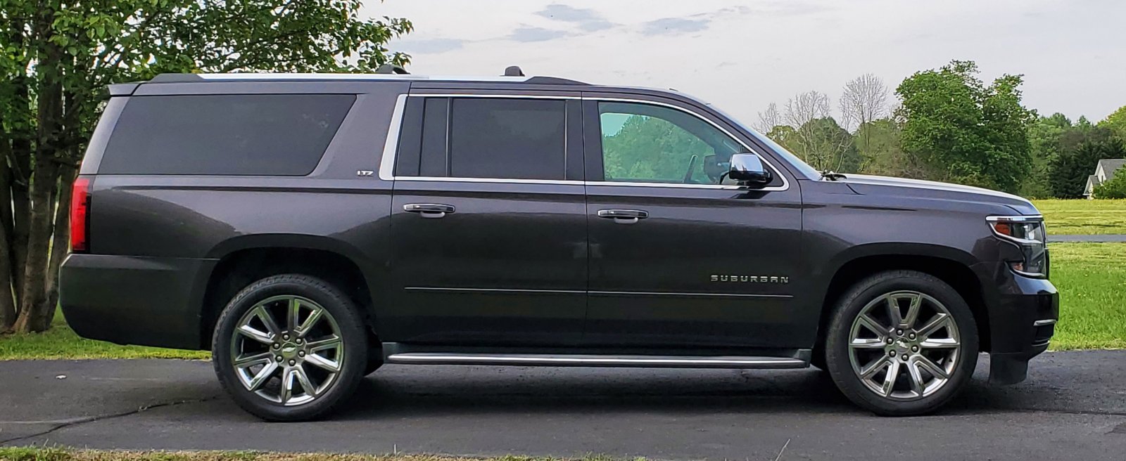

Stock stance.
2.5 in upper (3.25 in measured)
1.5 in lower w/ .25 upper spacer (2.25 in measured)
I may change the lower to the 1 inch, but I'll live with it for awhile.

i have the lower type spacers for the front shock. 1 1/2" Rough Country. it looks level to me. and with the addition af the Bilstein 5100s i got that last inch i wanted to see. 2.5in total lift. i like the 2nd pic. That looks "right" to me.
