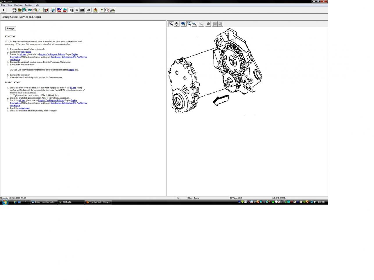

I have a oil leak in the front of the engine, not sure from where yet as I haven't looked. My question is how hard is it to replace the front timing chain cover if it turns out to be the front seal or timing cover gasket? I know on older V8 engines you had to drop the oil pan a bit to remove the cover and not sure if this is still the case...

here,

U sure its not the oil pan gasket? I gotta replace mine because its leakin like a *****
