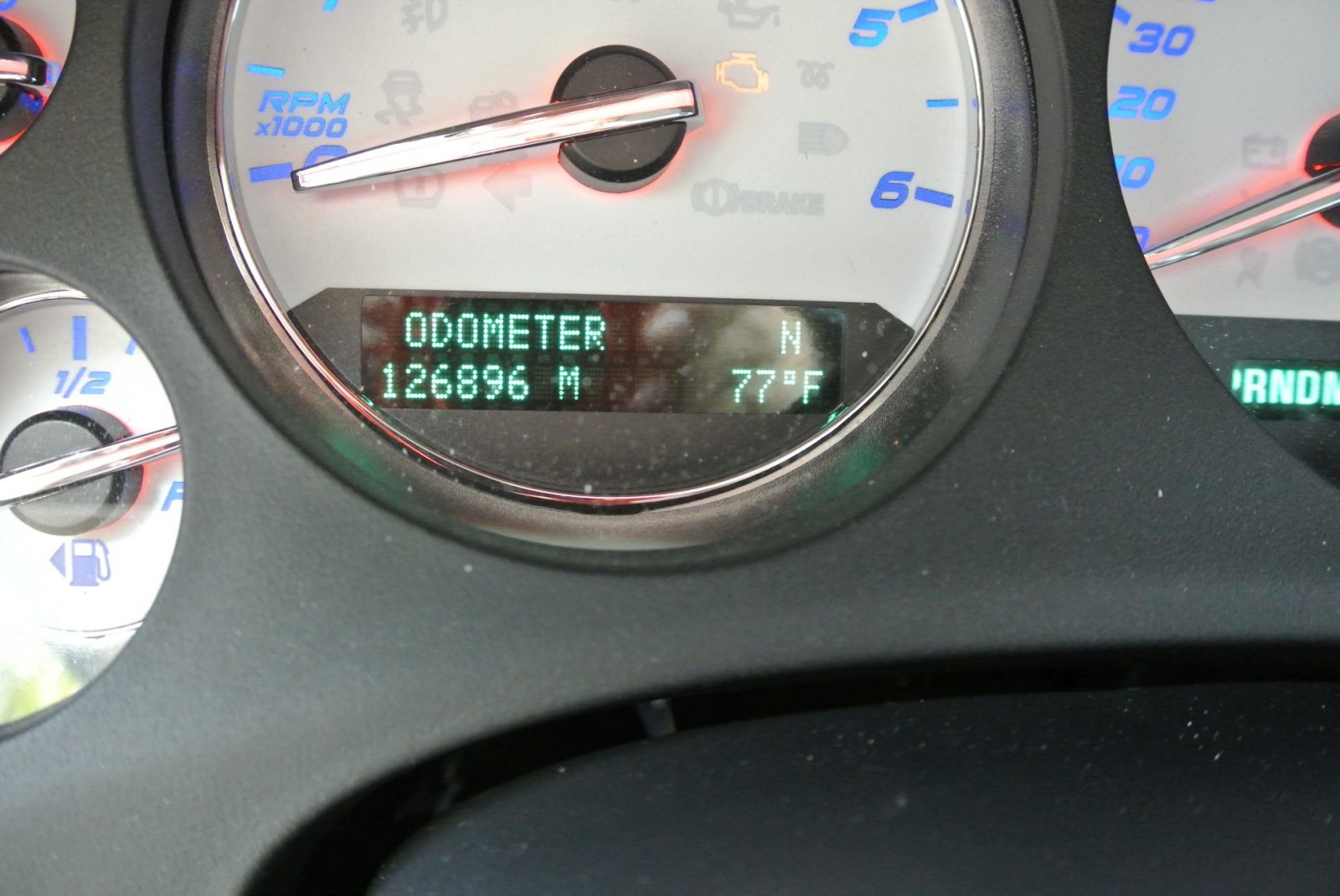

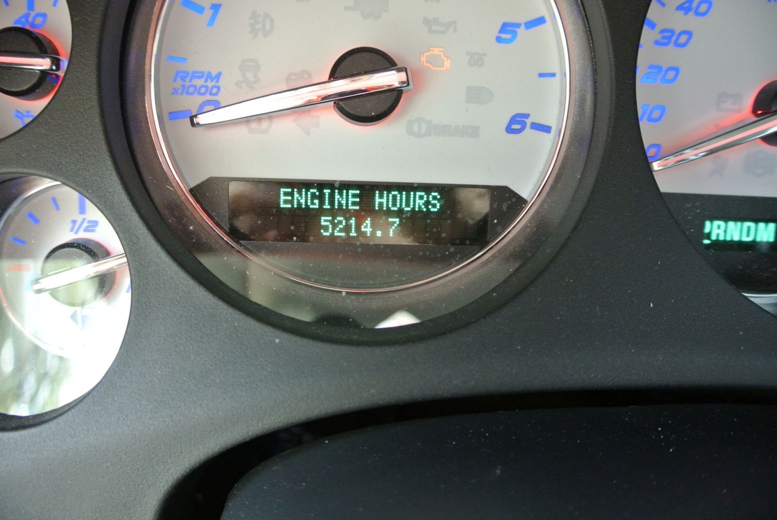

I bought mine at 82k it had a little over 4000 hrs, swapped in a ppv cluster and made sure the hours were transferred over and now I am at 127k with 5214 hrs that is just normal driving and idling. and I am on the original fuel pump
