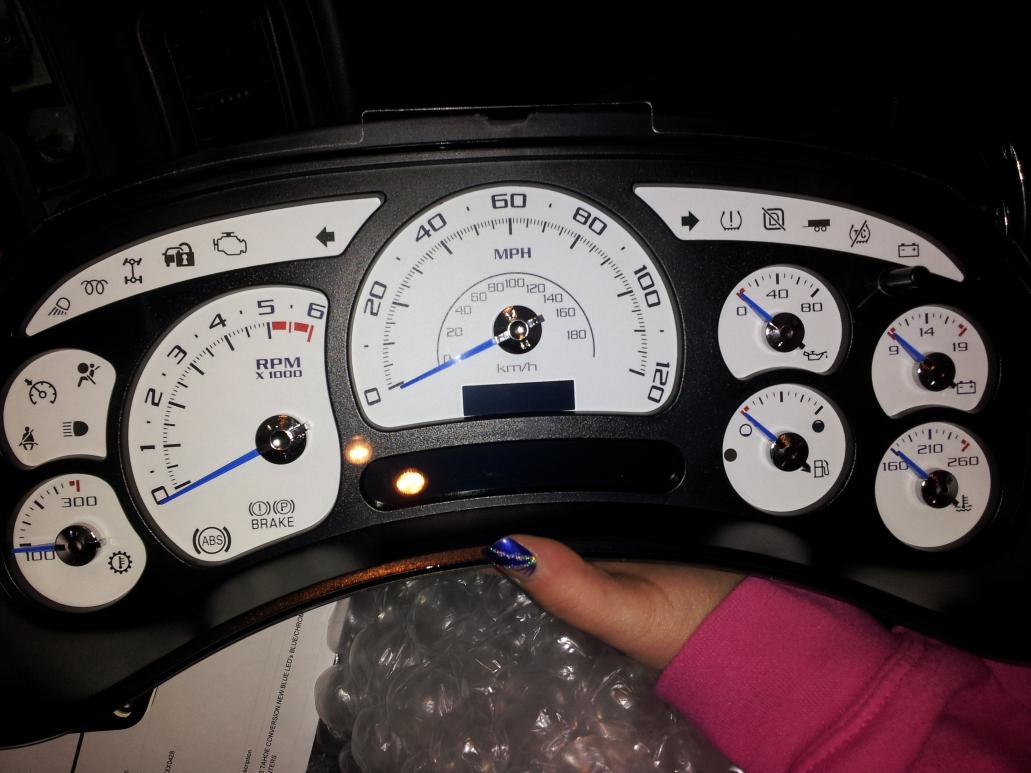

I just replaced my cluster from digital dash solutions on ebay. They have a form you print out and you list your mileage and engine hours and he programs it into the new cluster. Then either fax it or scan and email it to him. Then you call him to confirm what you want and you can pay over the phone with a card.
I bought a rebuilt unit and paid the $200 core charge so i had no down time with the truck.
He shipped it fast and the cluster was in perfect shape.
