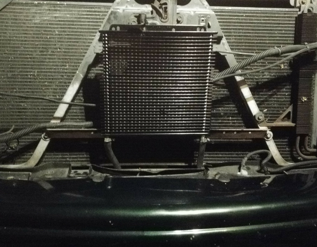

@MSDENEEN , if it has a trans collier stock, it'll be mounted in between the grill piece and the radiator. Like at @Red Rocket said, the factory one is pretty small. I upgraded mine to the tricolor 40k unit and it's awesome. Check out the first page of my build thread for a couple photos of the cooler.
26,004
50,862
You mean TruCool not TriColor lol.
