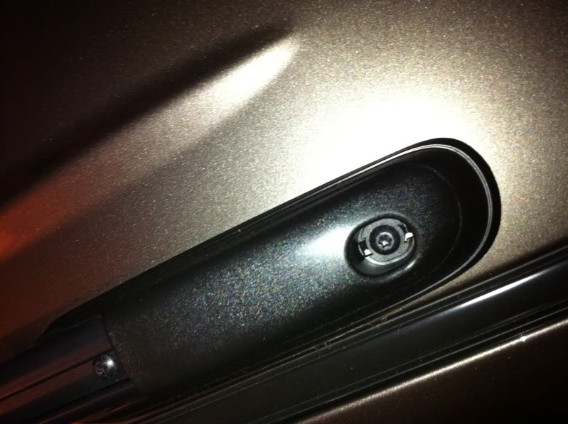

I removed the torx screw and the cap came right off. Then you slide the cross bars all the way rearward and off. Helps to have someone assist you in the sliding them off part.
This is the screw, you will probably need a ladder to see it unless you are 7 feet tall. Its a crappy phone pic, but you get the idea.
