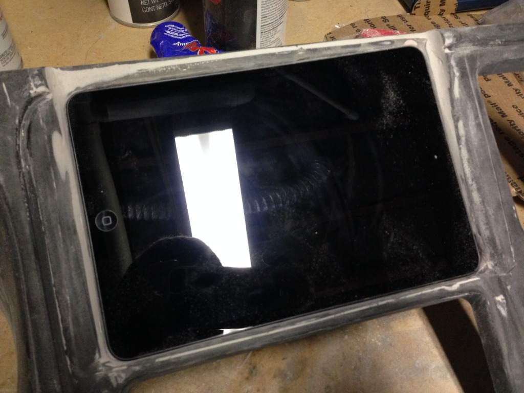

Yep! Ask any questions you have.
Unfortunately, you are not able to work the AC system with the iPad; its wayyy too complicated. As for the sound to go through the vehicle's speakers, I just use the Bluetooth feature on my Alpine single DIN headunit paired to my iPad. Then, I have both Metra interfaces, so that the Bose system works flawlessly and I can use my steering wheel controls. If someone is riding with me and wants to hook up their device for a few songs, I have an AUX cord coming from the Onstar wiring harness behind the dash that can handle that duty.
The iPad is held in the same way as SoundMan's tray. Although, I didn't have the heart to cut up a $50 Smart Cover, so I just bought 6 3/8" Rare Earth magnets and stuck them into the fiberglass resin while it was drying.
If you're interested, I am thinking about trying to get a run of my own iPad/iPad Mini trays molded up. They will be made out of a thicker ABS, that way you can use whatever type of epoxy you want. I would need a good bit of interest to even consider having them made- the mold alone is ~$400. I would sell the trays at cost; it would be about $75.
I'll get some updated pictures tomorrow- apparently I never took finished pictures... :rollseyes:
