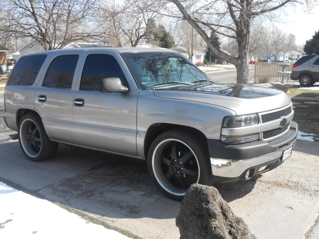

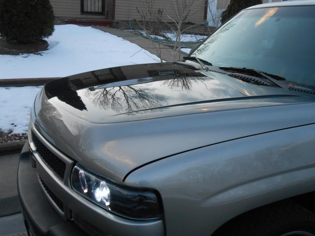

are you talking about the 01-02 HD front end like the one i have? if yess then you wont need new fenders the ones you have will work..if you want the whole conversion you will need the hood the grille and the upper bumper pad..now its all bolt on exept you will need to cut the bumper mounts and weld them about 1.5" lower here are some pics i took from when i did it
heres a before and after
if you have any questions just send me a PM id be glad to help
