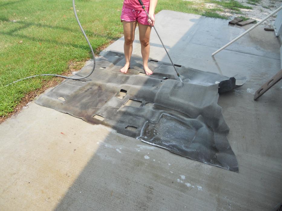

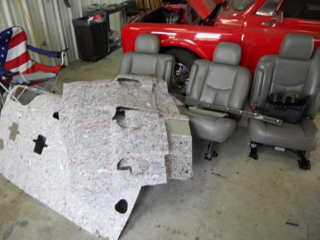

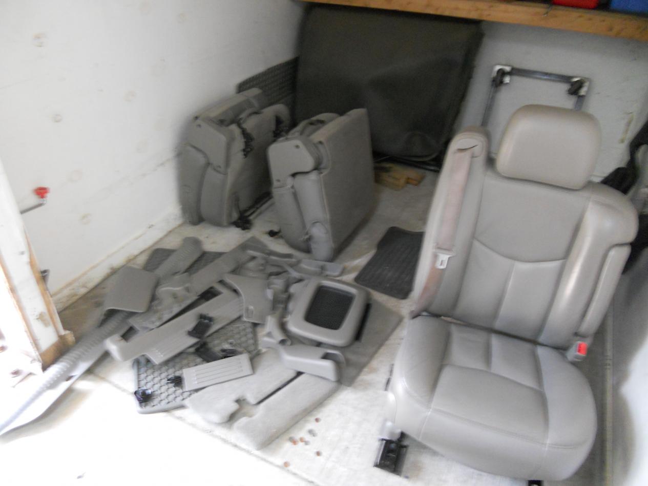

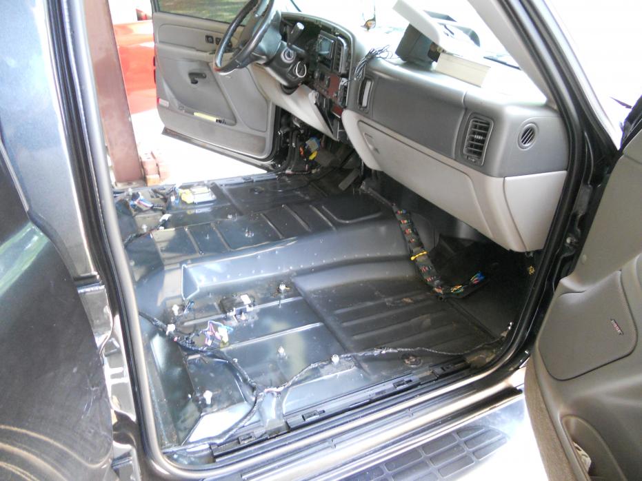

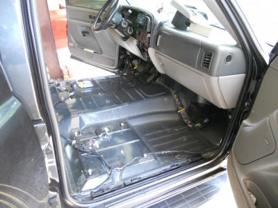

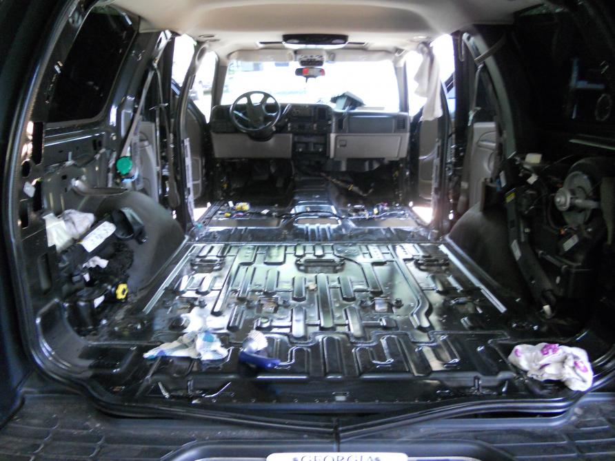

Me and my wife in the middle of seriously cleaning the interior on the yukon. We breaked for lunch, here are some pics.
We bought this rig back in june and are the 3rd owners. A couple of soccer mom/ drunk party girls must have owned before because there was spilt and dried coke EVERYWHERE like around all the seat bolts.

I know this is off subject, but what are the details on the red truck in pic. Looks alot better than any Tahoe interior to me. Is it a 68-70 chevy?

yeah that is my 72 c/10 putting 1.6 roller rockers and 4 core aluminum radiator and E-fans with controller

Pressure washed both sections of carpet 2 times with simple green, the first time washed the water was dark brown......

No I did not take any step by step pics for removal. There is nothing hidden or hard to reach, hardest part is unbolting and unplugging front seats and lifting them out. (those are some heavy bitches if they are power everything)
unbolt all seats (11MM and 15 MM for front captain seats)(19MM or 20MM for 2nd row captain seats)
unhook 3rd row seat (if equipped)
there are 2 bolts for center console that bolt it to the bottom part of dash
they are located behind power ports trim piece under HVAC controls
after you unbolt that everything thing else just snaps or clips into place
now keep in mind this is a yukon if you attempt to do this on a denali or escalade I'm sure there will be a few more trim pieces to unhook and def a few more wires for 2nd row like if you have heated cooled seats. That is just from me looking around on forum I have never worked on a denali or esky.
