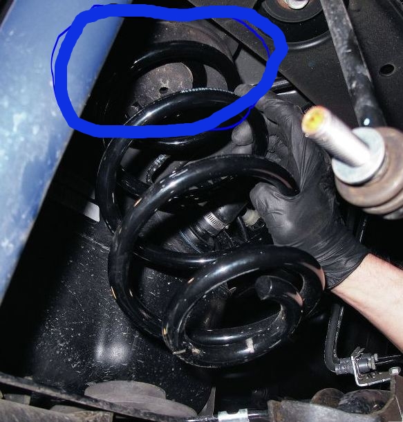

Not at the moment. If you are looking at the rear of the truck, ther top of the spring is moving all the way to the left of the perch. Not staying centered, if that makes sense.
Not my picture but this is the right side of as yukon. if the problem were on the right side, the area in blue would be shifted to the right and the spring would contect the frame when put on the ground.
