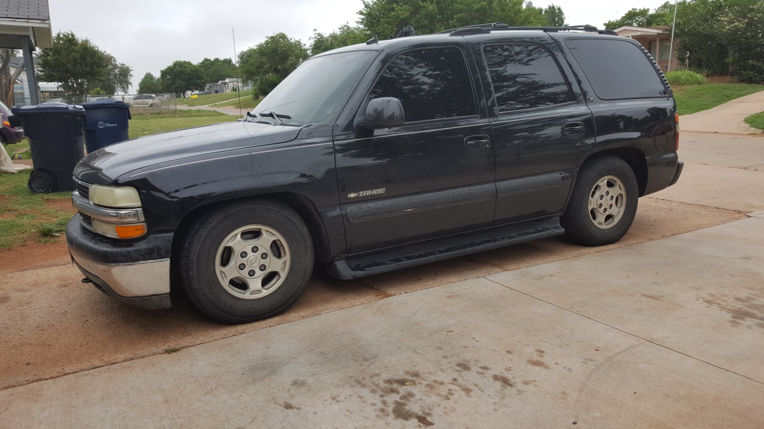

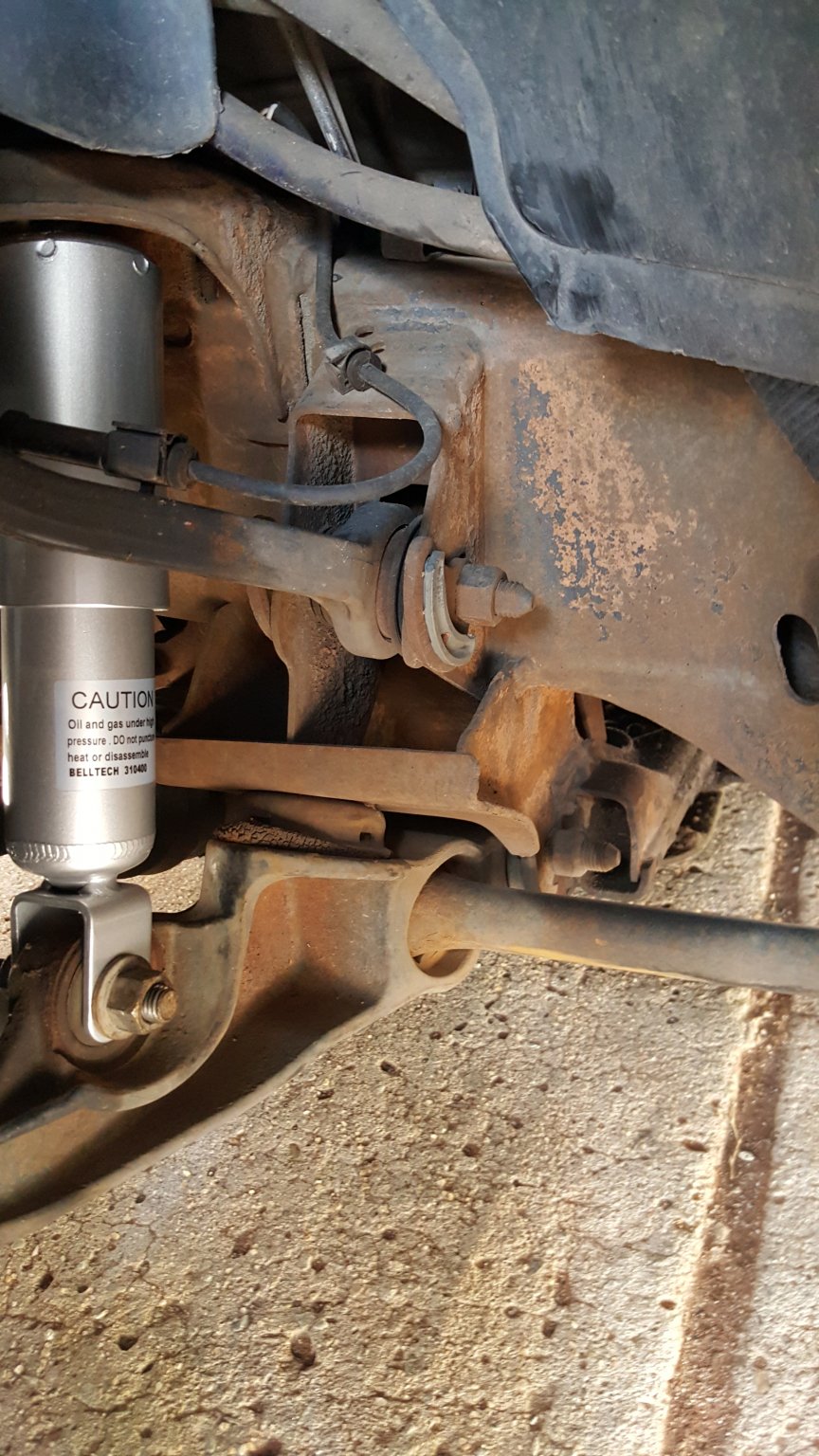

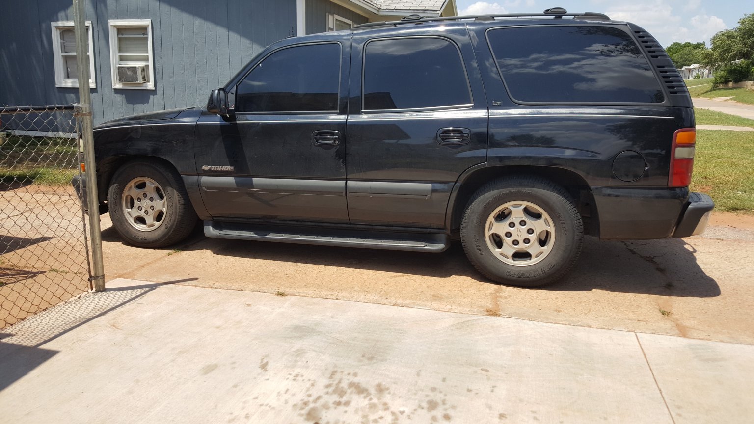

But after taking it for a ride, I noticed the front end was bouncing extremely. So I went back to look under and found that the front bump stops are compressed all the way down. Is this what is causing my tahoe to bounce so much? I turned the keys all the way up but that didnt work. Any Ideas on what I could do? 20160610_143004.jpg 20160610_175322.jpg 20160610_175437.jpg

Those are actually " jounce stops" and they're designed to be in contact. They're not a solid rubber like the rear bump stops but a softer material. Yours look like they're worn out. Replace them; mine looked way better than yours but when I pulled them out to put new ones in, I could see they were deteriorated. New ones made a big difference. Dorman part # 905-208 . They're used like a leverage point for the torsion bars.

Looks like you have the front dropped pretty low for just using lowering keys. That might be part of your problem. I haven't ridden in a rig with those installed but it was recommended to me to go with drop spindles for anything over an inch or so. I ended up with the Belltech ones and although it was more expensive, the front actually rides better than stock now. Hopefully the jounce stops will work for you, otherwise you know what needs to be done! There's always dropped lower control arms from DJM or drop spindles.

That's way too low on keys only. Your control arms are sitting on the bumpstop cup. New bumpstops won't help in that case. You'll have to crank them back up and go with a lowered control arm or a dropped spindle if you want to go lower. Keys aren't good for a lot of drop. If they are cranked all the way up and still hitting you may have to reclock them.
