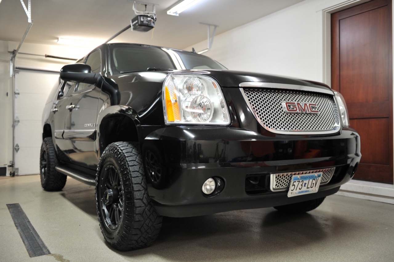

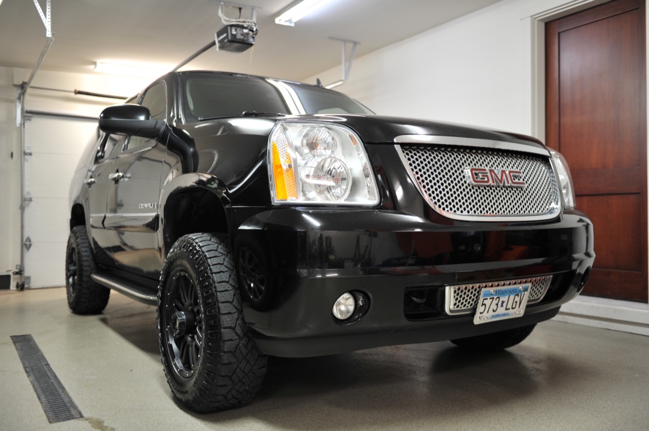

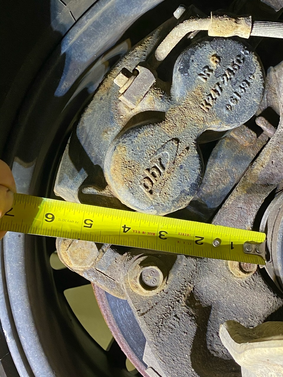

I’m running American Racing AR901 17” x 9”? et24 and still have 1/2” till it hits the brake caliper.

I found it easier to rest the tape measure on the axle housing while taking the picture with my other hand. ;)
