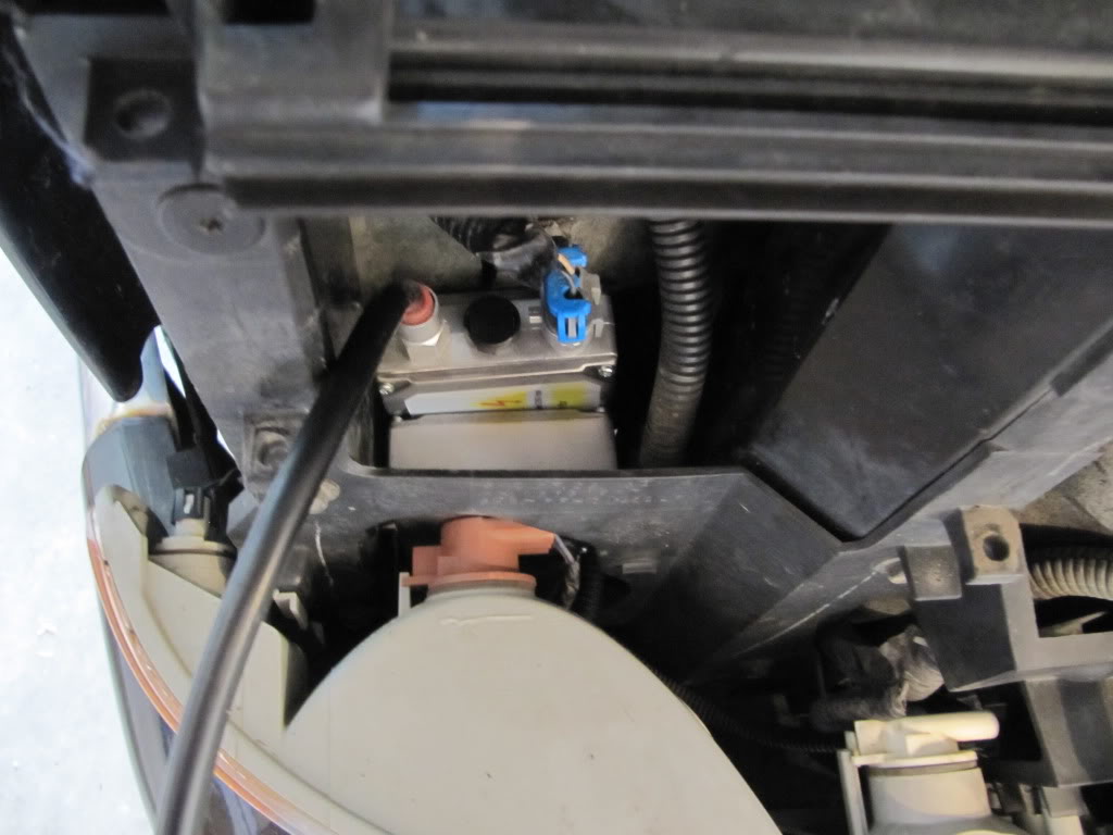

Behind the passanger headlights is a perfect spot for both ballists to fit i have the fog lights pointing down there is a perfect spot to run wires down

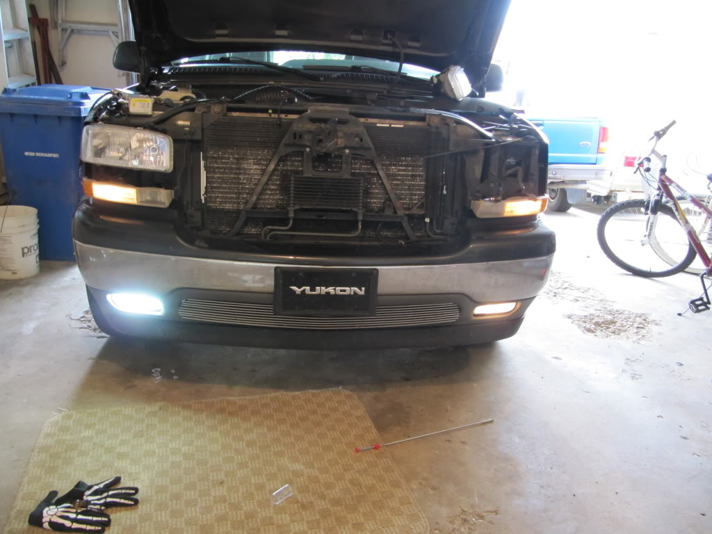

heres a comparison pic for the fogs

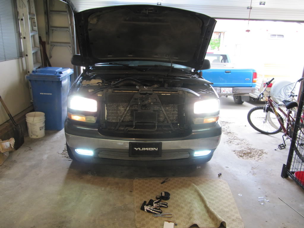

and here is finished with the 6 hi mod
and let me tell you they are amazing at night they can probably see me from space
