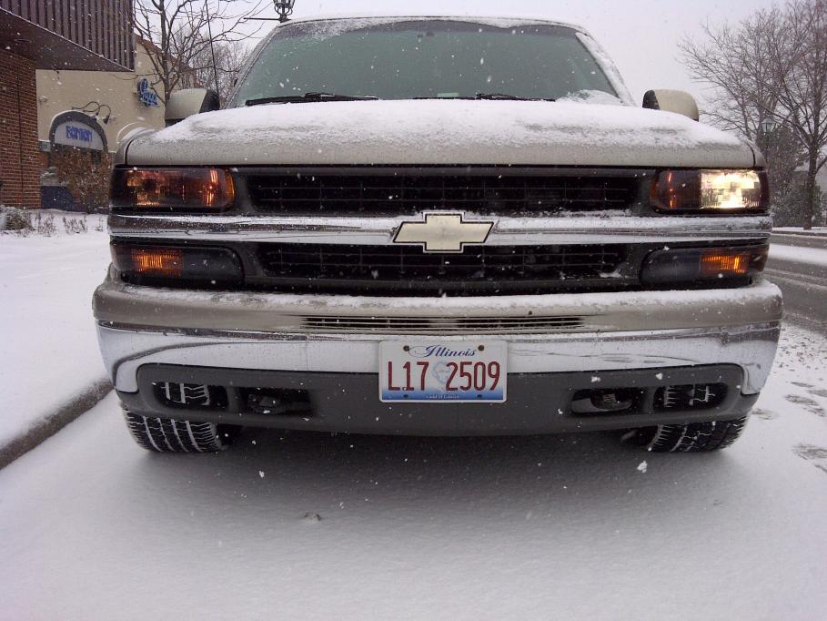

thnx guys do you have a link to those HIDS, and my problem is still there, i was told that it was some sort of grounding problem, any guess?
this is how it looks now with regular lights, took off my supposed HIDS

I would say that you definitely have a ground issue-without a proper ground you will not see full voltage. I bet if you probed that headlight connector with a VOM you would see low voltage. I would look closely at that connector to see if it is coroded or burnt. Also check to see if there is any rub thru on those wires. Seeing as the driver's side works fine-I'm guessing that it is the passenger side plug. Check it out. You can always get a new plug and splice it in.

Blown headlight fuse. I forget which fuse it is but it's in the fuse box located in the engine bay. Had my drivers side front lights do exactly what your picture is showing. Replaced fuse all was fixed.
The blown fuse in my situation was when my driver's side HID ballast went bad.
