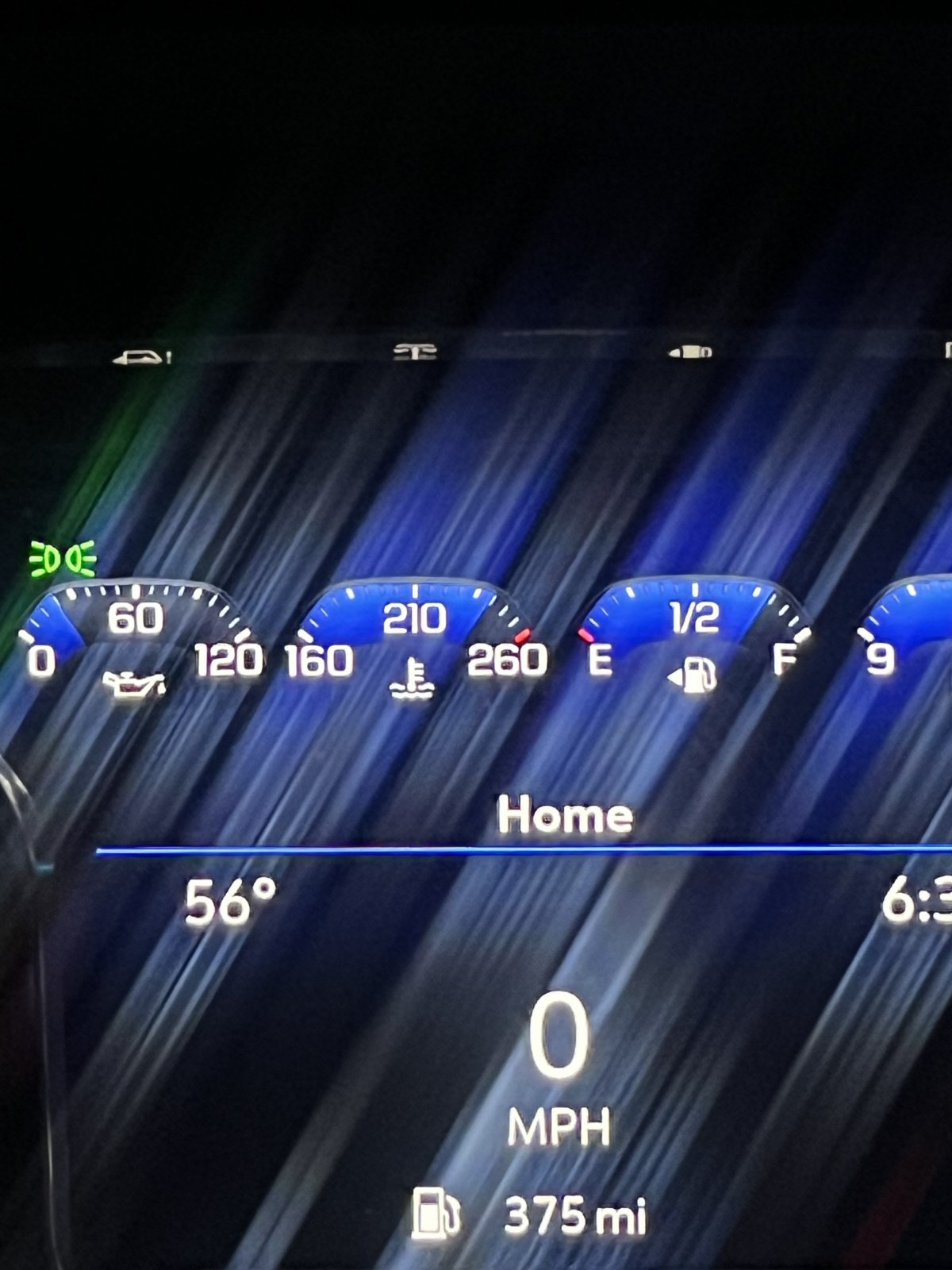

Currently out of town, but the wife is having problems with our 21 Yukon Diesel. She drove it today to work with no issues. When she went to start it, while in park it was sitting at 1000 RPMs with the check engine light on. She drove it and it started to overheat. I won’t be able to pull the code until I get home tomorrow.
Any ideas of what may cause this?

From what she said was that it started to overheat. I just checked it and I don’t hear the fan that she heard. Check engine light still on with a P1006 code.

it won’t let me post a video but there is a fan going at idle after the car sat all day at work. Temperature that day outside was 50-60 degrees. Check engine light was on. She started to drive it and immediately jumped the temperature gauge that high. It reached 260 and the vehicle went into a safety mode. I got home today and the engine code I was able to pull was the P1006. It went on a flatbed and when I got to the dealer, the check engine light was off.
