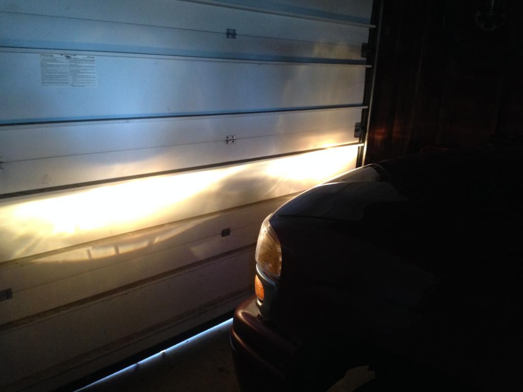

Here is a pic of lows with 9005 Ultrastars.

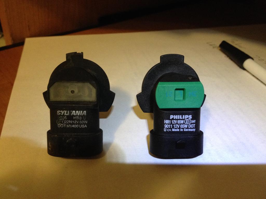

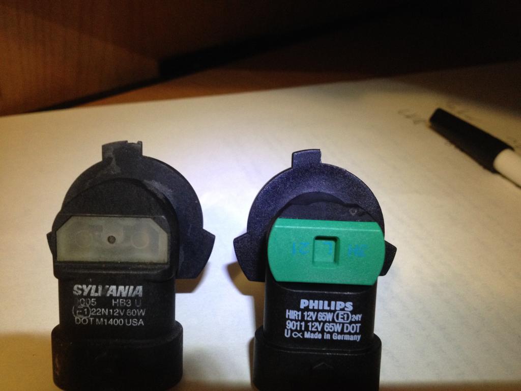

Here is the minor adjustment you have to make to top tab.
before trim
After trim

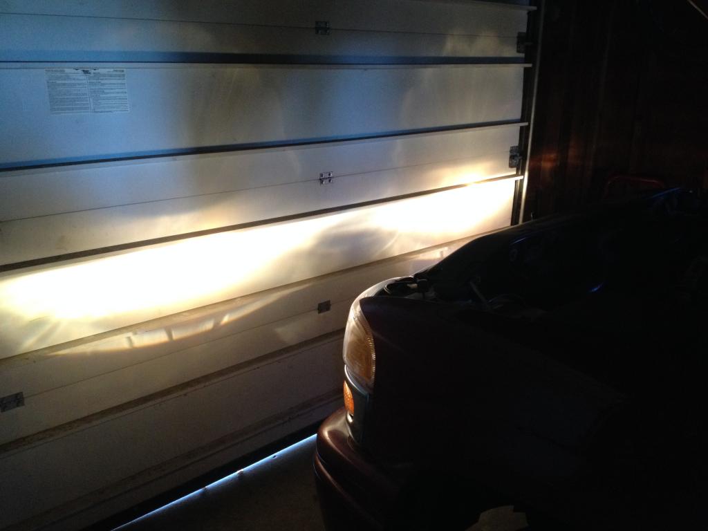

And here is after the Philips install
Like I said, very hard to tell the difference, but nighttime visibility is so much better.

Cool work man. But wow those glare alot! How about on the road shots so we can see the difference?
Yea. Glare is because the lenses need to be restored. Getting a little hazy from Michigan winters.
I will get some road shots this week. I leave for grand cayman soon. So may have to wait a little haha.
