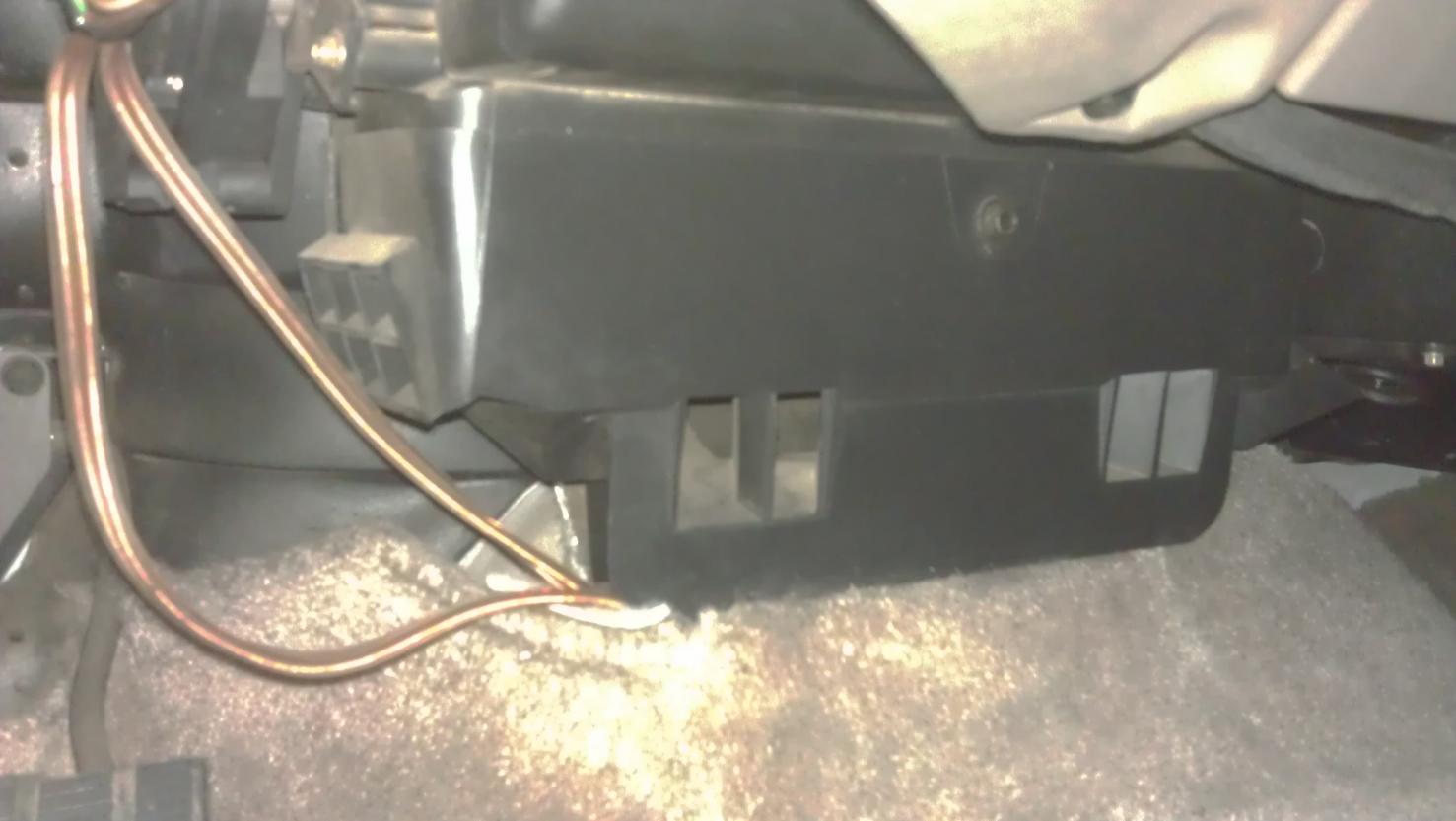

I've recently noticed that hot air is coming from thr floor vent in the middle underneath the dash. Is there any way i can make it stop? Could it be my hvac controller or could something be stuck? Has anyone had the issue with thier hoe? thanks again
98chubby
Aug 4, 2011
76
Its on off the temp control is on cold and the fan control is off, and yes it's all the time. Do you need a picture?

The venting controls are to the up and on the left side of that box.
Stick your head up in there as best as you can and then move the control knobs.
Can you see the controls moving around? Any binding? I"m guessing that the flappers are not moving in the full range of motion.

So if they are stuck should i just move them around or should i replace something either the flapps or hvac? thanks for the help

Check for varying voltage on the control wire on the actuator as you move knob back and forth.
I'm new to the whole voltage check i'm more into the if the tester light doesn't come then their is no power. Could that work too?
Hopefully your not into replacing the flappers. It's a fairly big job. You have to take off the entire dashboard.
Did you see anything binding in there?
I suppose it will just get bright and dim as you move the control knob. for the mode control door it would be be the white wire that has varying voltage as it moved. If you do not see the motor shaft move and the brown has a constant 12v and black has a ground then I would suspect a broken motor or stuck door.
