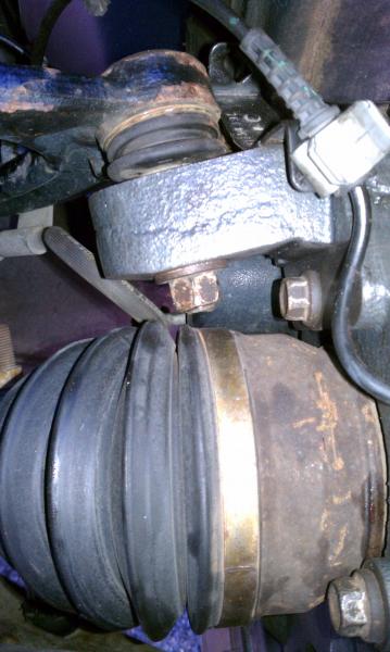

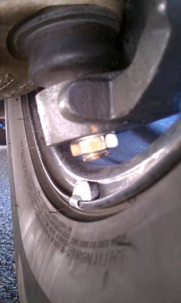

you most likely going to need trimming. Those studs are pretty long. YOu can see in this pic the length of the stud before trimming. In my pic you can see that i had to trim pretty much to the nut.
