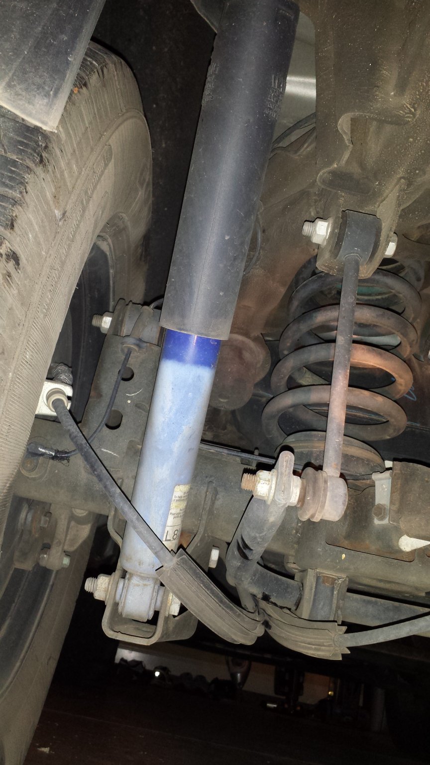

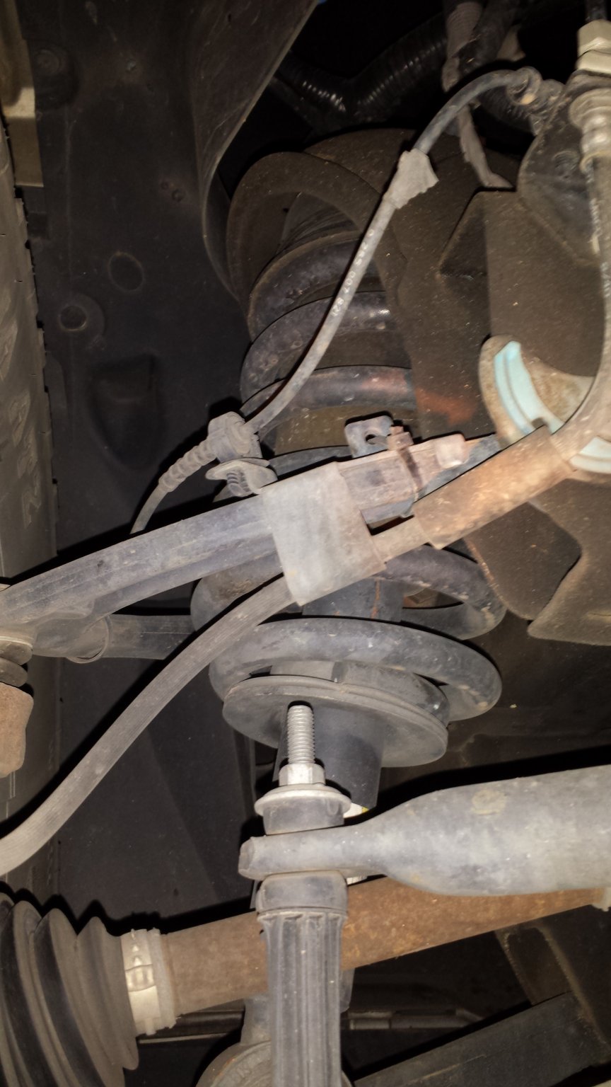

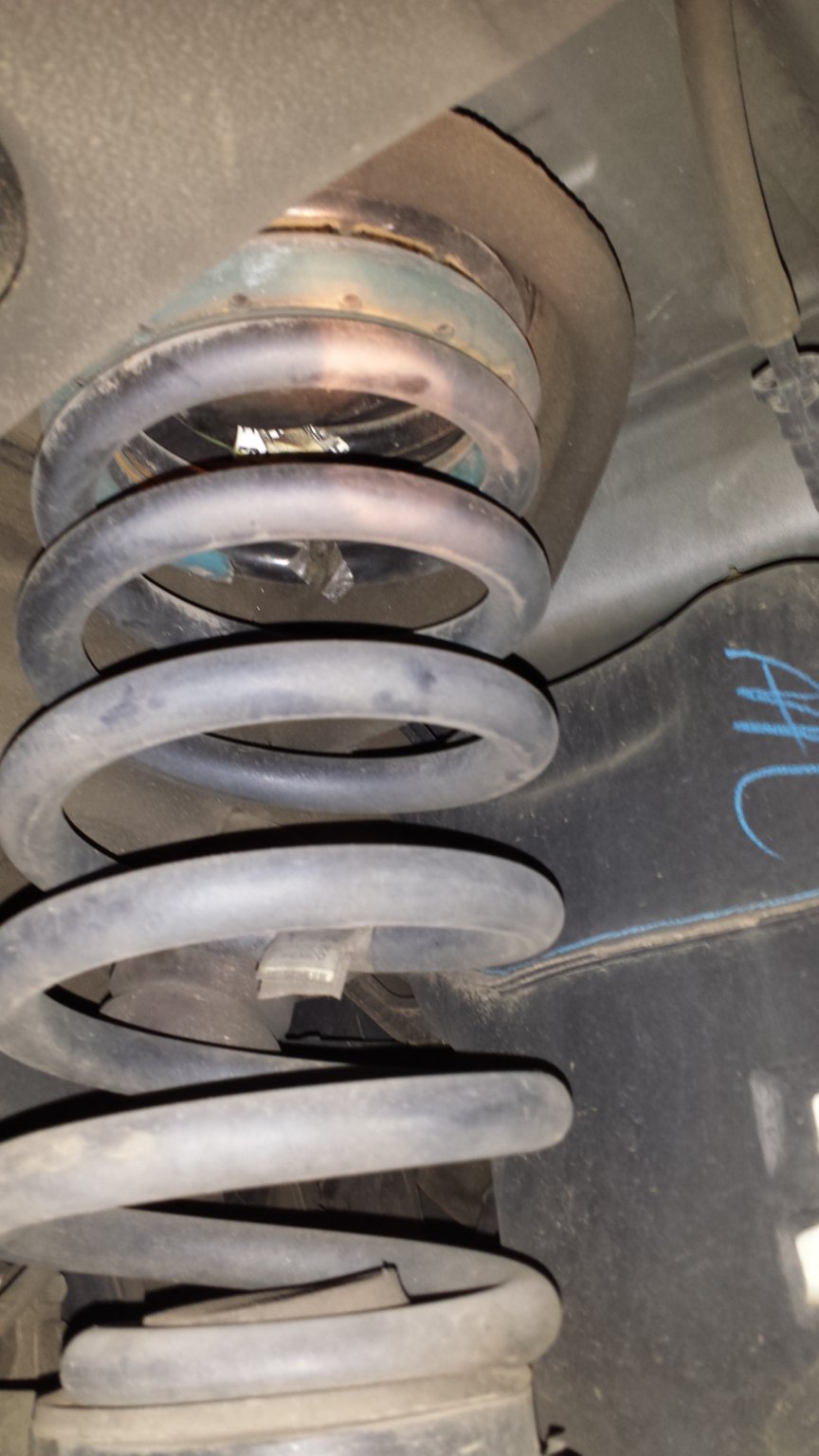

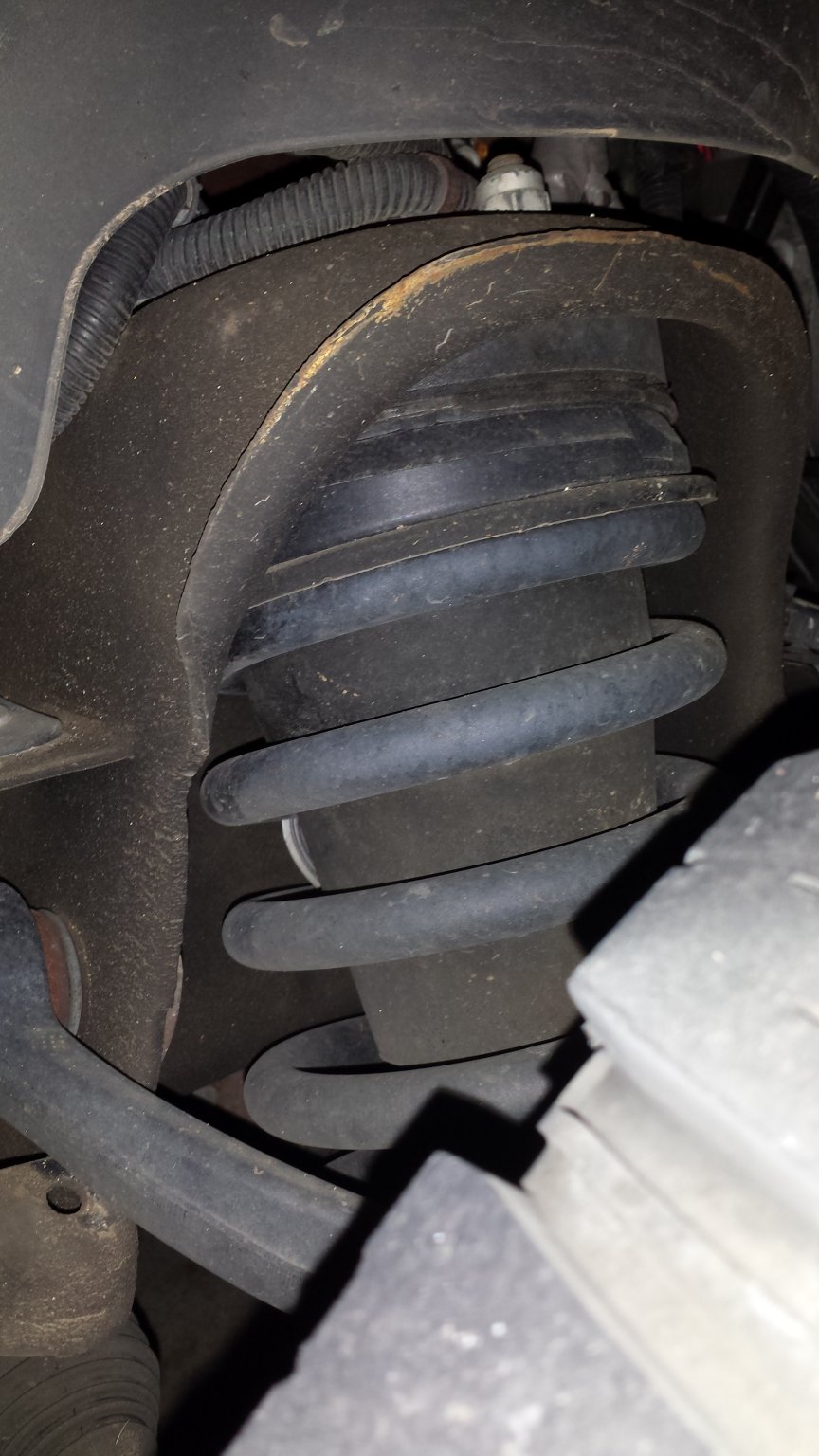

I purchased this 2010 LT Tahoe for my wife and it has 305/60R18 on it. I'm guessing it has about 2.5 inches of lift on front and by the look of the rear strut, about an inch on the rear.
Does anyone recognize what exactly is on here and how much lift it's providing?

Looks like a basic leveling kit, close enough to what you said in your first post. Why are you asking tho?

Looks like level or shit wash on rear strut and you are light load and full extended.

Also in the rear it looks like you may either have no lift or possibly a 1 inch spacer or smaller. The front will be a spacer between the strut and mount with the 3 bolts and nuts. The rear should be a spacer on the bottom of the spring. Both are easy to install and should be easier to remove. Either way you will need to do an alignment for the front to get it back to specs after you remove the lift. Also just bc its a different color on the shock doesn't necessarily mean you have a lift. That could be caused by anything. Good luck and congrats on the baby. I just had my second about 4 months ago so I feel ya pain with making the ol ladie happy. Good luck with that as well lol.

Rear looks stock as I don't see any spacers in between axle and spring or top side on frame. Not sure why shock color looks funny, maybe picture angle. Front is probably a level kit so 1.5" to match stock rear height. Weak if you wife complains about a kid going in a Tahoe with a front level kit, order a 7-9" kit then tell her to complain.
