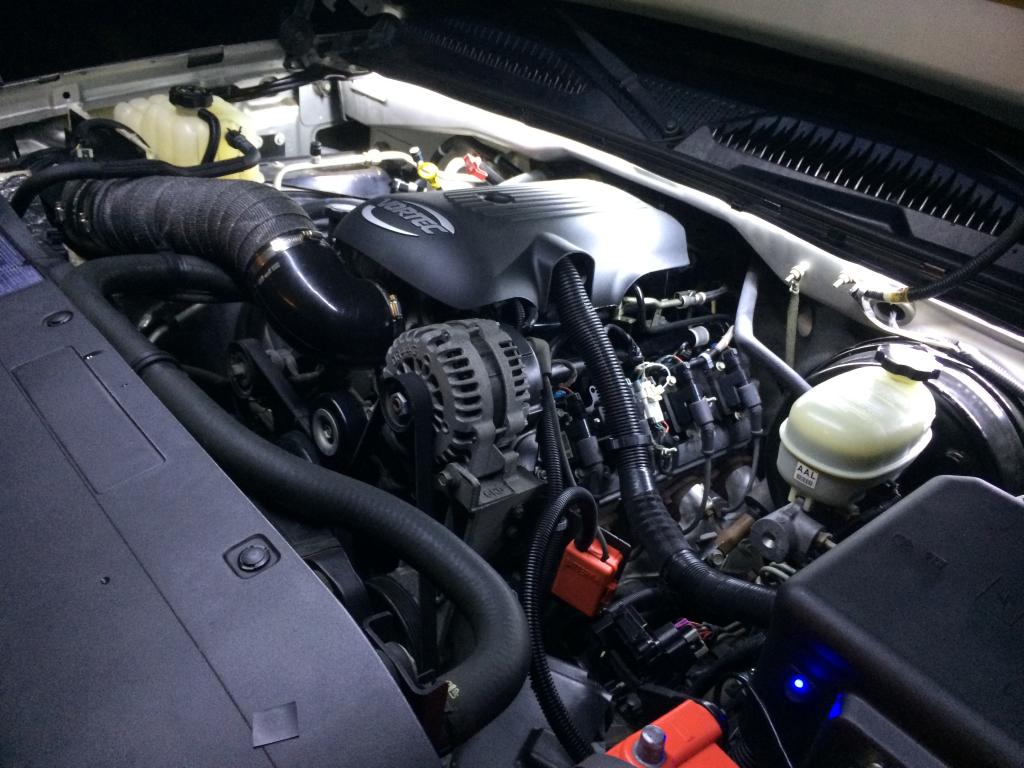

6: Step back and smile! you now have a spotless engine bay that is AWESOME!
No more will you have dirty hands working under the hood.
Now grab a microfiber cloth and a swifter dust thing and go do your interior.
Pop that hood in a day or two. That's when the Silk shine has fully dried and has spread evenly. Its a awesome sight.
