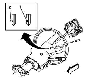

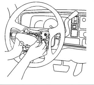

this is the closest thing i was able to find. Let me know if you need any other instructions. i couldnt find anything about clocks spring but i assume u're trying to install the air bag module on the steering wheel ?
1. Position the inflatable restraint module to the steering wheel.
2. Connect the electrical connectors to the inflatable restraint steering wheel module.
3. Connect the CPA retainers into the electrical connectors. Seat and lock the connections.
4. Position the alignment posts of the inflatable restraint module to the holes that are located on the steering wheel housing.
5. Push the inflatable restraint module into the steering wheel in order to engage and in order to latch the 2 leaf spring fasteners (1).
6. After installation, pull the sides of the inflatable restraint module in order to ensure that both leaf spring fasteners are engaged.
7. Enable the inflatable restraint steering wheel module. Refer to SIR Disabling and Enabling Zone 3
