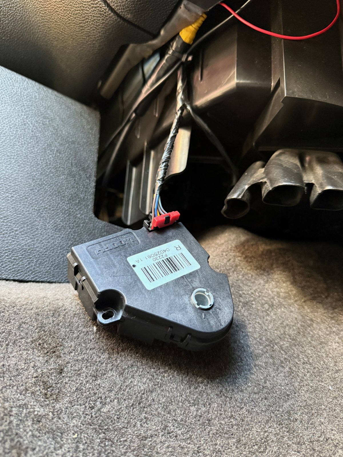

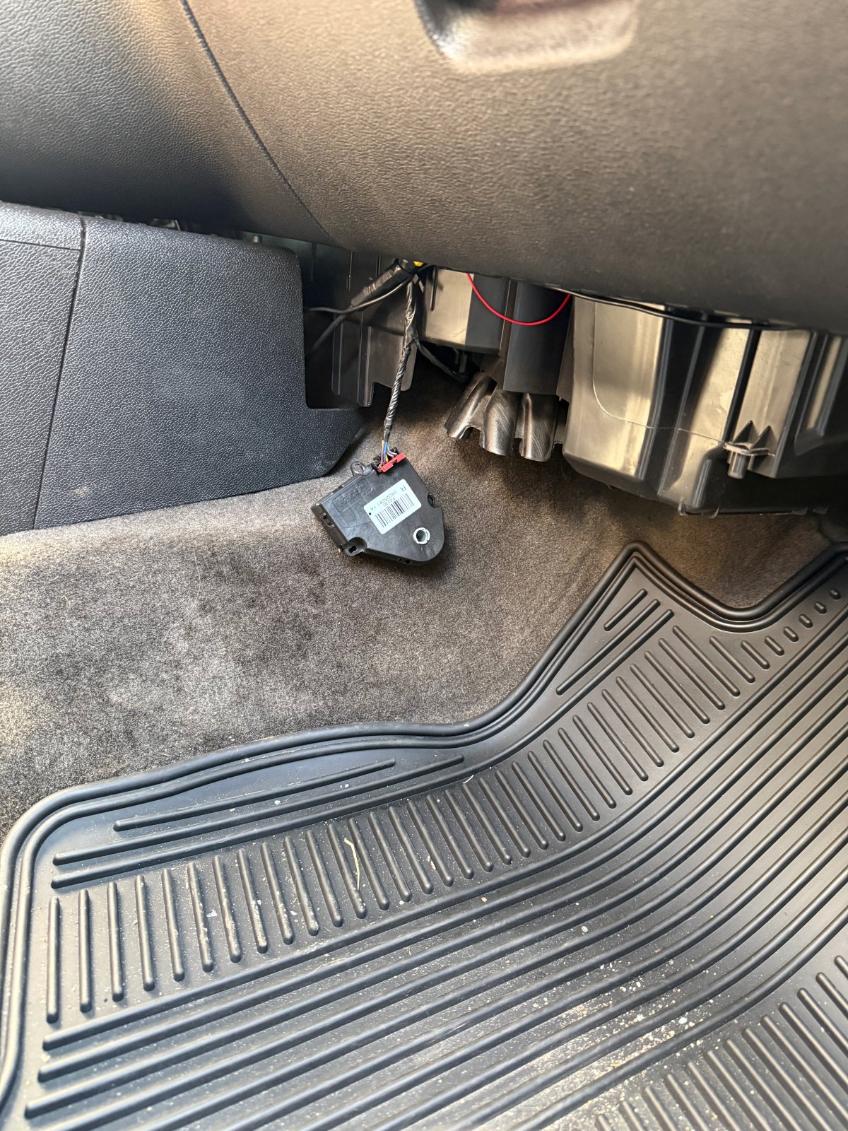

Thanks for the detailed feedback on what different locations are. I belive from your comment I re-read and I believe I know what one you are refering to, or not exactly but kinda. Wonder what the one I have is for. I took some pictures. English is not my native language so I might have misunderstood though.
30,500
47,889

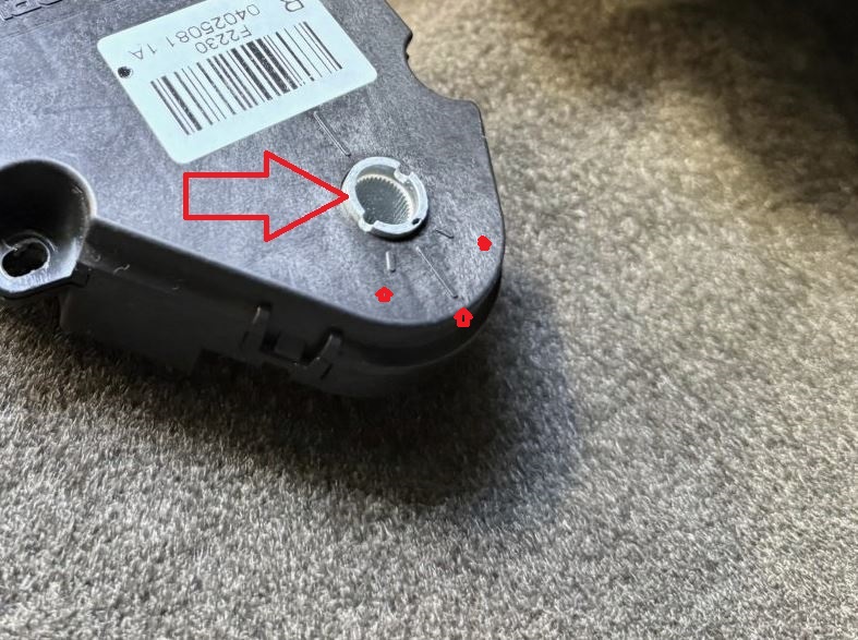

30,500
47,889
when you adjust the temperature you should see this metal ring rotate, one way is hot, the other way is cold.
it should move to all 3 position marks on the plastic housing
A
audunfr
Mar 9, 2026
8
Correct, and it does. So that is why I'm stunned that when I manually change the position it's still hot, like it does nothing. But I can feel the resistance of the shaft/stub rotating and things moving inside — the damper is definitely shifting — yet the air remains warm regardless of which position it's in.

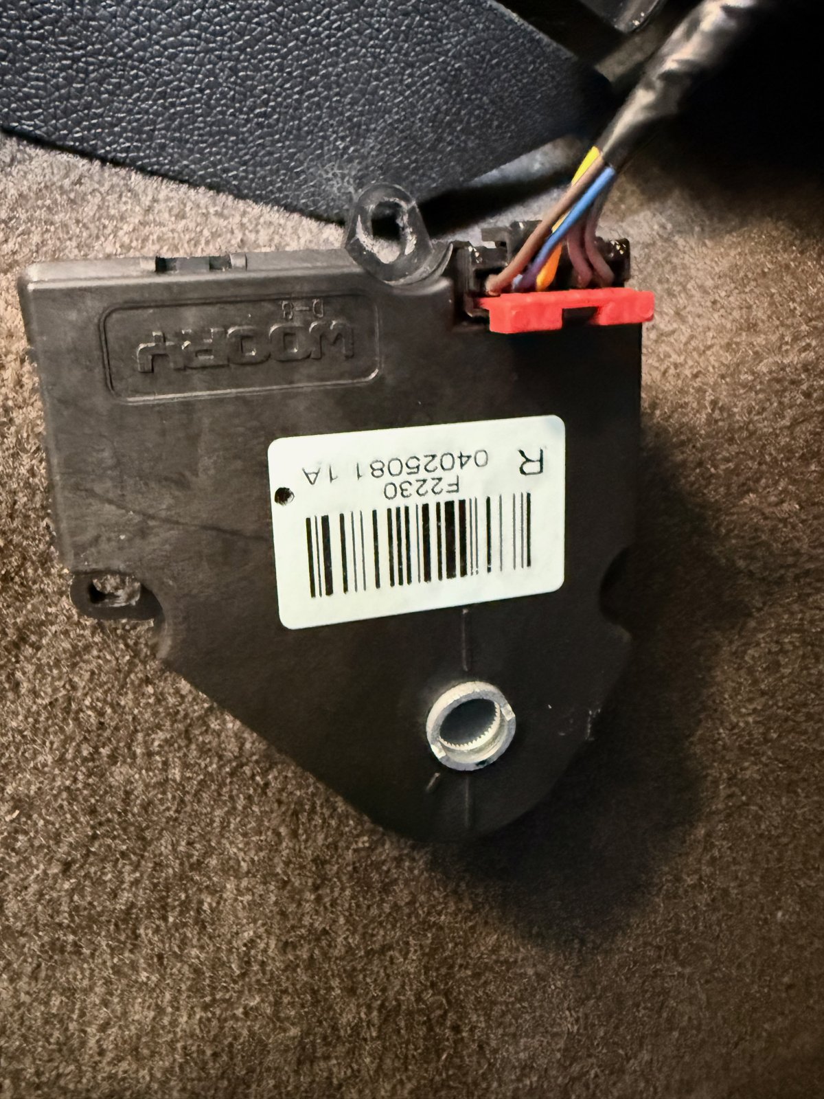

Here's some pictures of the left temperature valve...
30,500
47,889
first thing to do is verify the ac is working properly, if there is no cool air it's not going to cool no matter what you do.

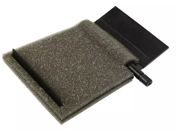

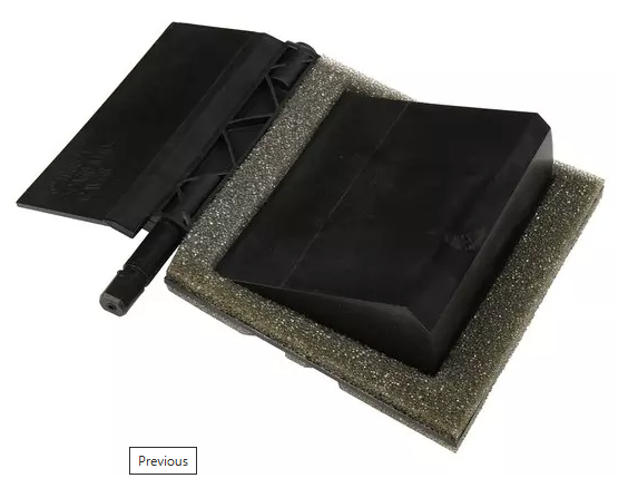

Got it back from the shop today. The mechanic diagnosed the temp door actuator and it's all good. Filled new gas and it is cool on the passenger side. They (the shop) think it's something inside that is broken but did not have time to diagnose further.
I see the RockAuth has https://www.rockauto.com/en/moreinfo.php?pk=1041580&cc=1442911&pt=10640&jsn=8 - HVAC temperature valve door and I guess the actuator is connected to something that do move but inside the air duct its not (broken plastic or something). I tried searching YouTube but most videos are about the actuator so I need to do some digging to see if it's an easy job to take this out and inspect.
