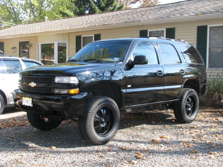

Im pretty happy with the kit i got from zone offroad,only 2 things,one the fuel filler tube they gave me was 1 inch in diameter mine was 2 inch no big deal i had something sitting ther that worked.Other was rear bumper brackets didnt line up in frame without notching them alittle,nothing a grinder couldnt handle.Worse part was getting my ss bumper to fit back on.Where you have to cut front frame horns for normal bumper you need to cut all of the front off and trim some more so the bumper sits back far enough.Im gone to try and add my tow hooks but ill do it later.Took 4 hours total to get it done.I could only work 3 hours yesterday and an hour this morning.I had a relapse friday of the sickness i have(sarcoidosis) i shouldve waited till i got better but i pushed to get it done.Barely held the impact gun up.BUT its done,now i need steps,lol.Im short.Ill paint the frame this week if im feeling better.One pic for now need to take it out somewhere flat get measurements and some better pics.

thanks guys i need to put a mesh insert like the grill in the bumper cover to hide where you can see the ends of frame and i need to find square fog lights to fit in it also.
