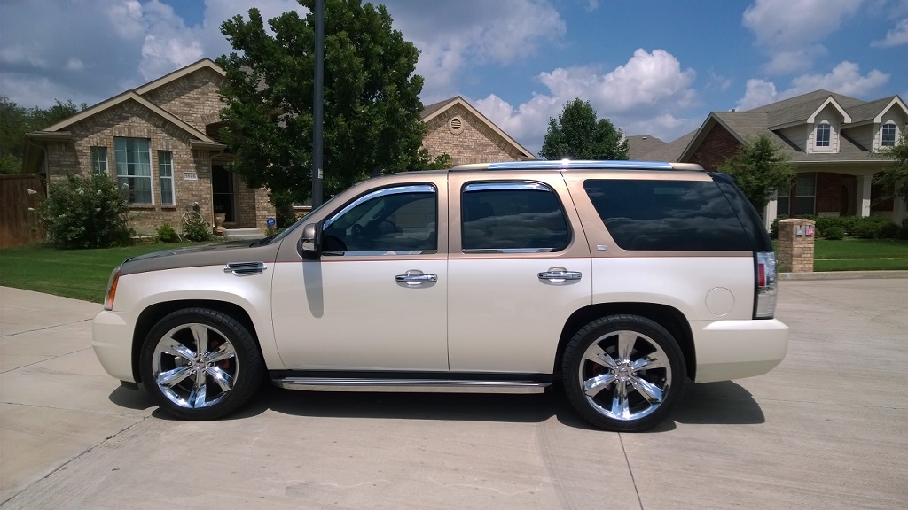

After coming into some cash, I sent the truck off to Truck Toys in Arlington, TX. Truck toys did a Belltech 3/2 complete kit drop + roll bar, magnaflow exhaust, and SuperChips tuner.Yukon Post Drop 001 - Copy.JPG Yukon Post Drop 002.JPG Yukon Post Drop 003.JPG Yukon Post Drop 001 - Copy.JPG Yukon Post Drop 002.JPG Yukon Post Drop 003.JPG

I loved the way it looked once lowered. However, once it was lowered, I started to have some (minor, depending on perspective) issues. First, I started getting tire rub on sharp turns. I spent the next 4 years or so cutting out various parts of my wheel well trying to eliminate it. Found out recently, on my last tire purchase, that the issue was tire size. The Regency package rims came with 305/40/22. I simply assumed that was the appropriate tire size. Discount tire guy told me on my last purchase that the standard for our vehicles on 22" rims is 295/35/22. Needless to say, no more rub.
The next problem I had was that the vehicle had a loud, consistent rattle after I got it back. 3 years later, I took it to a different custom shop, and the guy there showed me where Truck toys had put the Belltech kit on with what appeared to be the wrong rear shocks. The connection to the truck had an inch on either side of the shock mount. You could see where, instead of trying to get the correct shocks, they tried to bend the mount on the truck. After several trips to Truck Toys 3 years later and some threats to write anyone I could think of, they replaced the Street performance shocks with belltech's base drop Nitro shocks, with the correct fit. Rattle eliminated, 3 or so years later...
