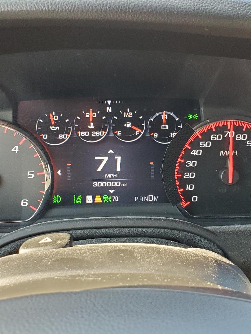

I made it! 2015 Yukon XL Denali, , 300,000 miles

Welcome to the 300K club brutha, good job.

What's the tape on the speedometer for?

Well, I'm kinda proud but it seems conservative driving and LOTs of maintenance can pay off. Now that I've fixed all the known problems, it seems i have a dependable vehicle that i can just drive and enjoy. View attachment 379233
