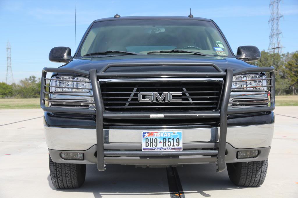

Thanks for the input guys. Went to a 3rd place and passed without question. I have driven alongside and against multiple police cruisers in day and at night without trouble, and have never had the issue of someone flashing their lights for me to turn off what they may think are my highs. Its not the stock housing, but its not projector. Will have pics up tomorrow and will link for reference.
Just glad I passed without having to swap anything. Its doable, sure, but still time consuming.

For mention, here are the tails and headlight housings of question:
