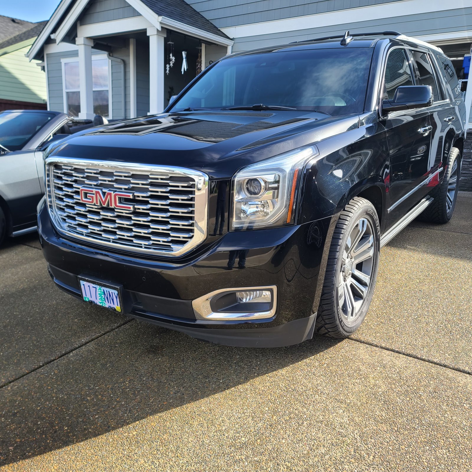

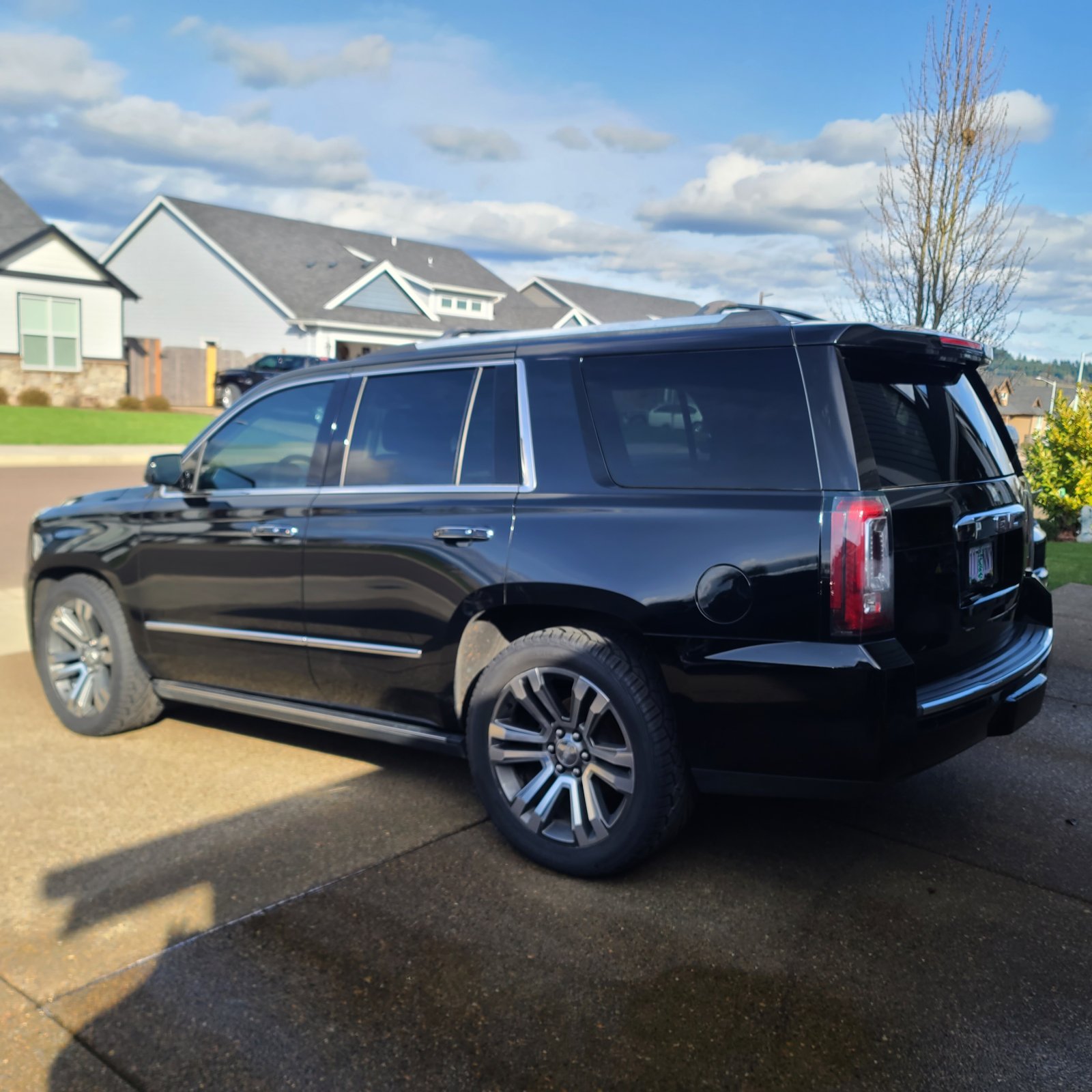

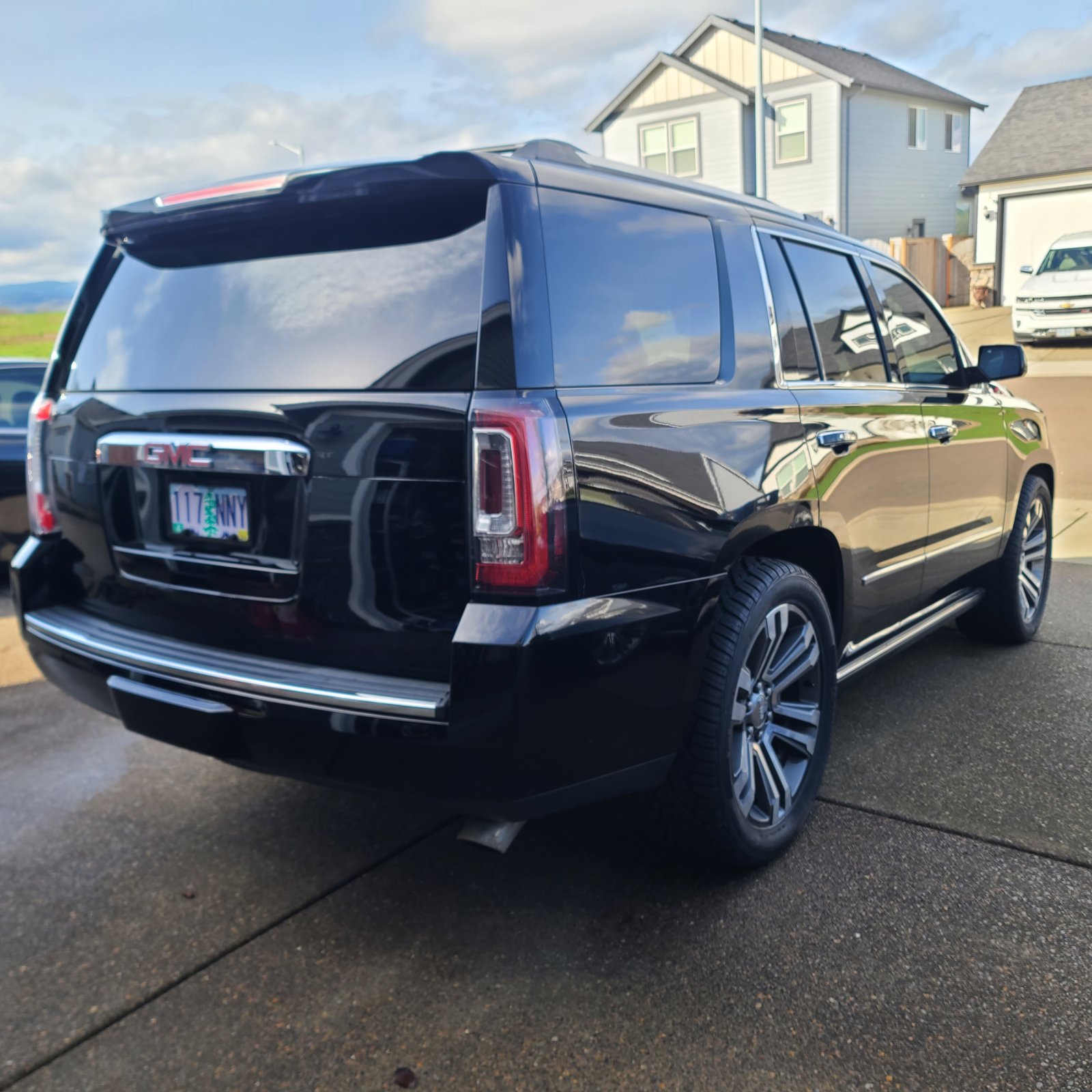

I really like the look of the 305/45R22 especially when lowered or at least just the rear lowered and stock front. Have always been considering this tire size with the vehicle lowered there just isn't enough info on the forum or web of many people running 305/45R22 on lowered SUV's. Plenty with some people running them on stock suspension and ride height or even with a front level/lift.
305 is a pretty wide tire for the stock 9" wide rims and the increased sidewall bulge shows that some in your pictures over the OE 285/45R22 size. My bigger concern over the sidewall bulge is the potential negative impact on steering response and cornering. With the extra sidewall bulge I could see there being a potential "delay" in steering response or sometimes after a quick change in direction there's a delayed reaction or extra vehicle sway as the vehicle straitens back out due to the additional tire sidewall "absorbing" some of the response/movement from the steering wheel. I'm not sure if my description makes sense or not, but it's my best attempt.
Two Main Questions:
1. Have you noticed any increase tire rub or contact with the larger 305/45R22 tire and being lowered?
2. Do you feel any negative impacts in steering or handling response?

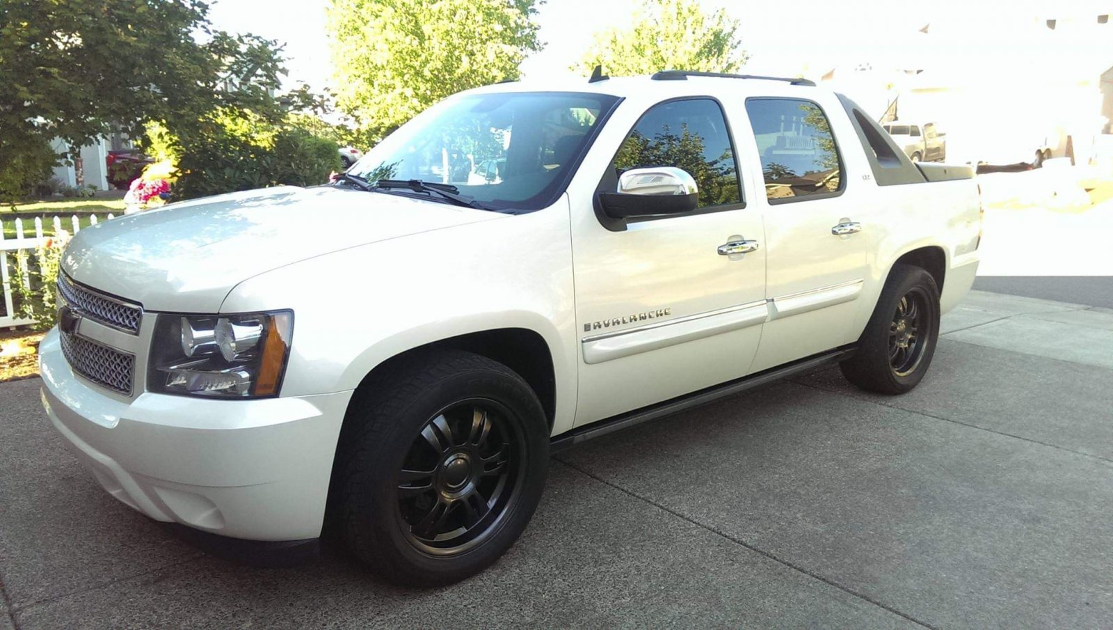

I ran the same setup with same drop kit except for 20" rims on my 2008 Avalanche and I had the pie cut/plastic weld the endcaps of the electronic running boards. The Yukon electronic running boards clear. Only have slight running in tight turns but have no rubbing on my 50 mile roundtrip for work. Going on vacation tomorrow so will address the rubbing when I get back.
The steering & handling feel better than the 285 Toyo tires that were on it. Wet traction is vastly improved. Very happy so far.
My Avalanche LTZ 4x4 running 305s with a 2/3 drop.
