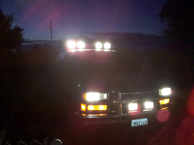

Hey guys. The weather is really starting to change around here, and it gets so foggy and awful around 6:30 (when I leave for school), so I bought a set of fog lights from autozone for like $30. It came with lights, a switch (with two male prongs) and wiring, but I bought a different switch that matches the blue on for my light bar. These switches have 3 prongs, so instead of wiring like the diagram it came with, I'm just going to use a relay and run it just like my KCs. Anyway, So as I'm working on it today, I take my dashboard off so I can remove that little plastic piece I'm going to mount the other switch to, right next to the other one. I don't know how or why, but when I disconnected the existing switch, I'll go to turn my light bar on, plug the switch back in, but nothing happens. I'm 98% sure the wires are all on their correct prongs, and I don't think I have any fuses blown.... ugh, it's just very frustrating. Anybody have any ideas on what I could have ****** up?
Anyway, here's a quick pic of the new fog lights. They're pretty cool; they came with covers, but they have stone guards.
