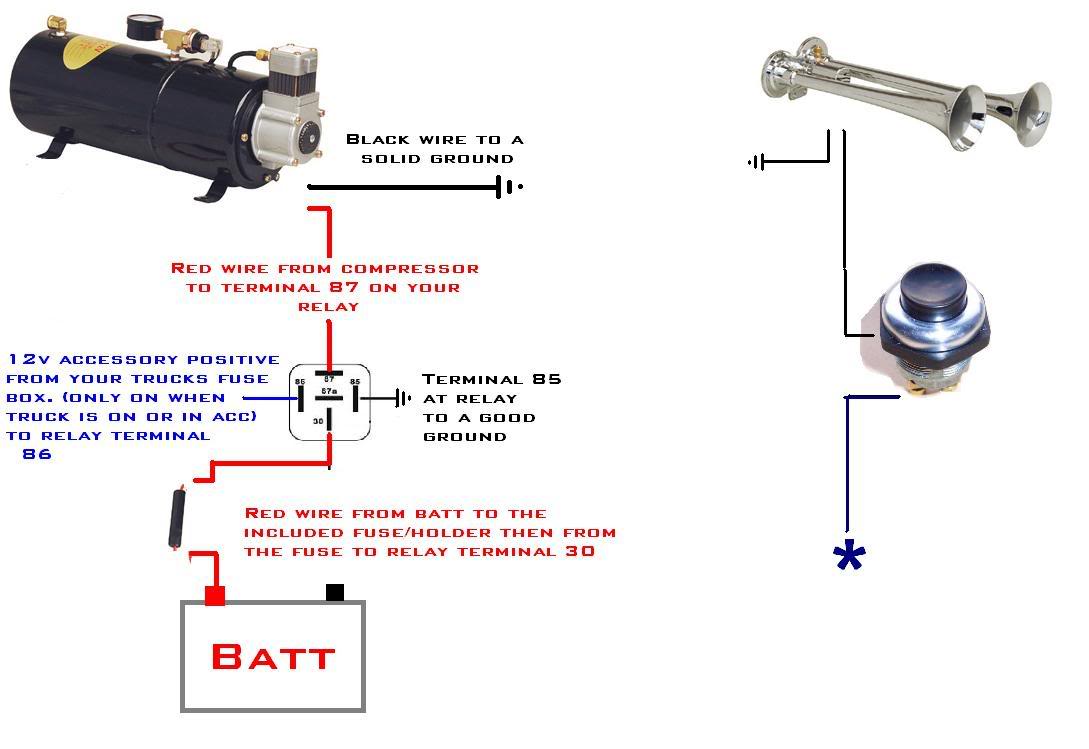

anyways heres how to wire a horn up in the simplest of terms..
use a dbl throw dbl pole toggle switch , discretly mounted under dash. if you want you can get some really nice, and SMALL lighted switchs to let you know your system is armed.
It's multi colored to visually tell you how your system is armed.
Along with a single pole momentary push button.
Sorry cant seem to find any round double throw illuminated (multi colored)rockers, right now..
Wire the solinoids trigger relay into that switch, so that in middle position the system is DISARMED, Forward and it operates with your standard horn.
Rear posistion it operates from the momentary push button.
Aswell as if you have aftermarket alarm with its own siren. link it to the train horn via the primary solinoid trigger wire. be sure to wire in a diode to keep the train horn trigger from setting off aftermarket alarm siren, everytime you blast it..
DONOT allow the compressor to run when your key is OFF, or you will find yourself with a dead battery.
If you get creative, you can run a duel batt isolation switch and a ATV battery to run the compressor when Key is off so that the horn will continue to run untill the comp kills the ATV batt..
Allowing you to satill start vehical.
