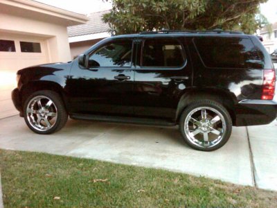

BUT only on one side...JESUS CHRIST it took so long. Used the goo gone/ 100% cotton towel technique and took me 6+ hours ON ONE SIDE. I'm guessing it's because my yukon is so old, maybe from all the heat the rubber has melted to the side... but anyways i'm still debating whether i want to take off the other side.. doesn't seem worth it after all the trouble i went through

lol, you cant leave just one side, that would look so ghetto
i did mine the hard way too, took me the better part of a couple weeks working on it for a bit every day... a lot of people said they got a 3m eraser wheel, it's n attachment for your drill, and they say it makes it a 1000 time easier.

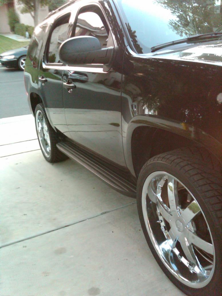

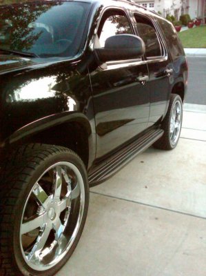

mine were color matched and were a ***** to get off using goo gone. Spray the top edge with the adhesive remover and slowly pull back as you use a plastic scraper to cut the adhesive against the molding. After using some rubbing compound and cleaner/wax/polish, I dont have a shadow, line or scratch at all. this was my molding removal kit.

so are you tryin to keep from breaking them? cuz if that was me I would just be rippin and tearin till they were all off even if it was in a hundred pieces.... but thats just me cuz I know I wont ever puttem back on
