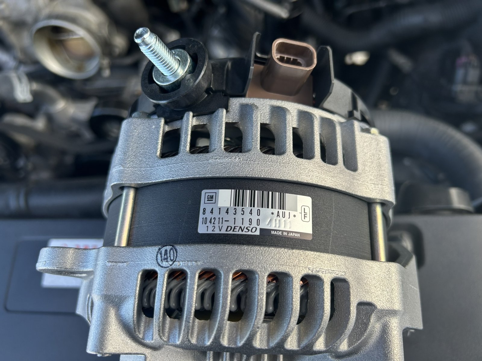

Sure enough, GM did not change the bolt hole spacing even with it being on the passenger side of the engine for the K2xx. Additionally, it seems as if all 2-pin GM alternators from 2004+ are the same pin and plug. It plugged right in. Only thing, you’ll just have to extend your alternator charging cable a few inches to reach the alternator terminal and enlarge the alternator side terminal one size with a step bit as the stud is 8mm vs 6mm. Also will need a M8 x 1.25 flange nut to bolt the cable on. Part number is 84143540, and the GM OE is made by Denso. It is a 170amp alternator vs. the OE 160amp.

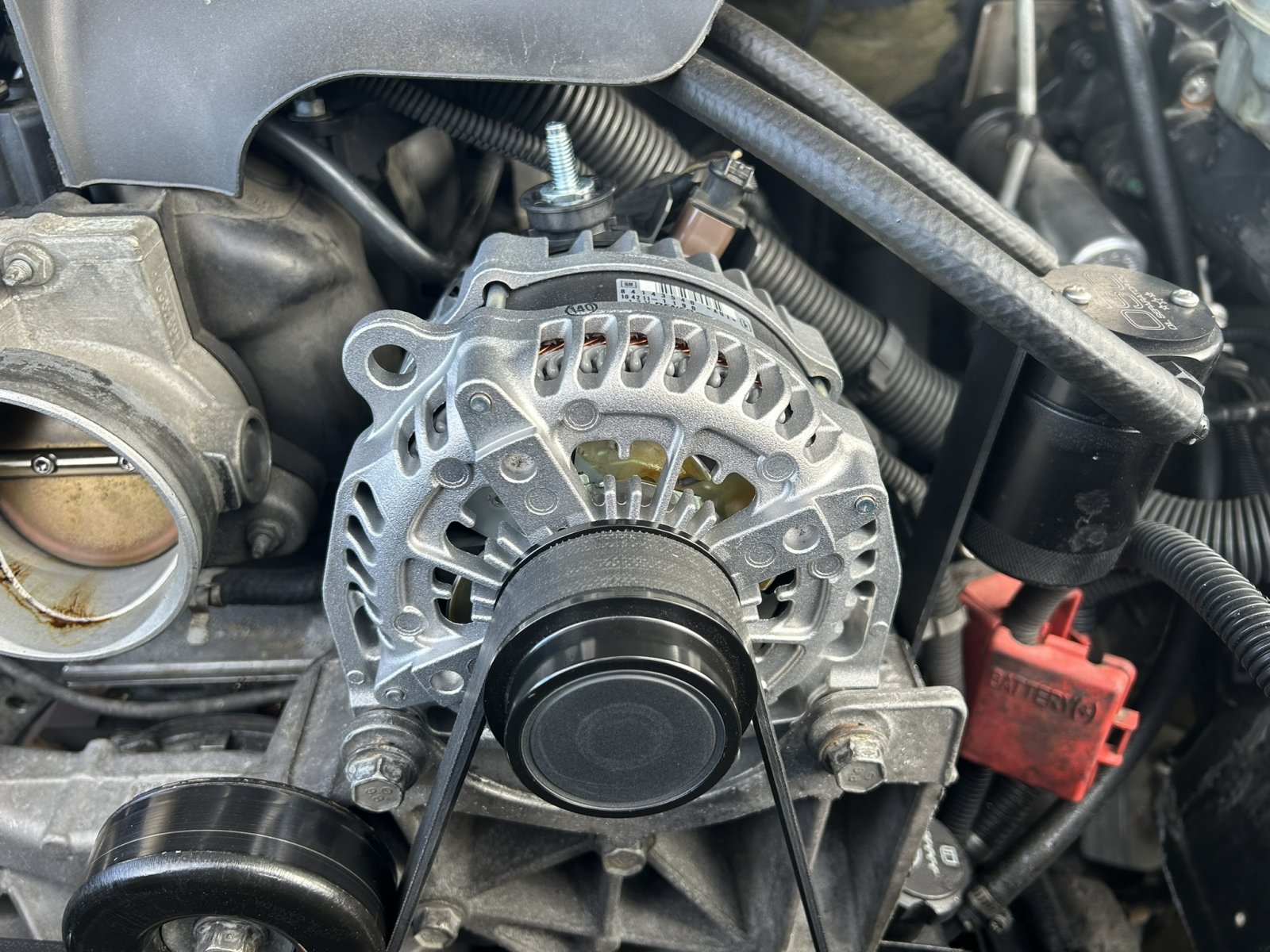

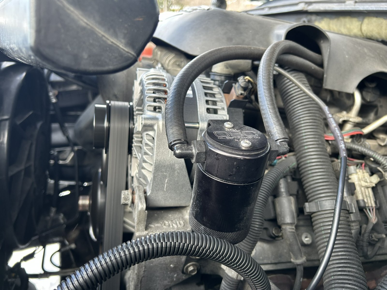

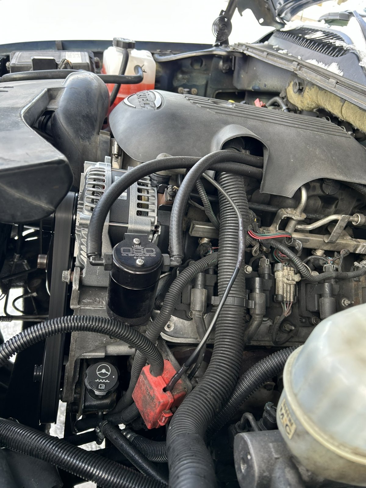

OE parts 9/10 times are the best. Here's some pictures. It does not look out of place. Charges great and makes ZERO noise. I am pleased. For the price of what'd you probably pay for a Duralast Gold, Carquest Premium, Orielly... etc. This is an OE alternator that will substitute just fine. Maybe this can help some of you out there. Worth noting, this will only apply to those of you with RVC equipped trucks/2-wire alternators.
