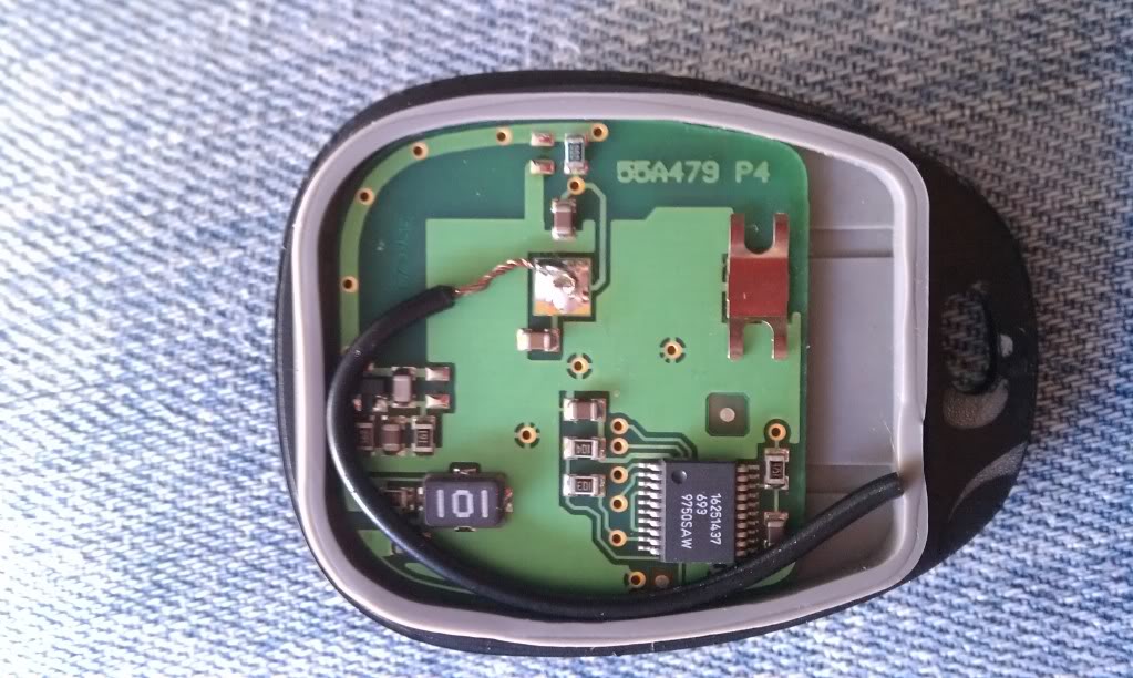

I was having trouble with my remote to i took it apart and I saw some black oily stuff on it so I put some alcohol on a piece of tissue not to wet and clean up the hole inside let it dry for a few minutes put it back together now it works just like new problem gone try this out first before buying a new one on ebay might save your self some money
Sent from my SM-N900V using Tapatalk
