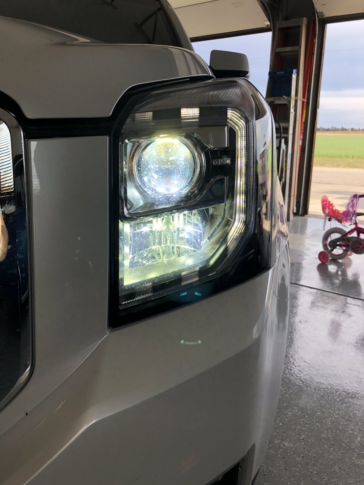

zkutilek
Jun 12, 2018
12
We have 6000k HID in our 17 Yukon and if you are straight on with them, they are pure white, but of center they are a little lighter blue than your halos. I think it would be a good match.
zkutilek
Jun 12, 2018
12
This is a 6000k HID low beam (projector) and 6000k LED high beam (reflector). Hope this helps!
Ps......pay no attention to the blank spots in the LED DRL, just the way the camera took the photo.
