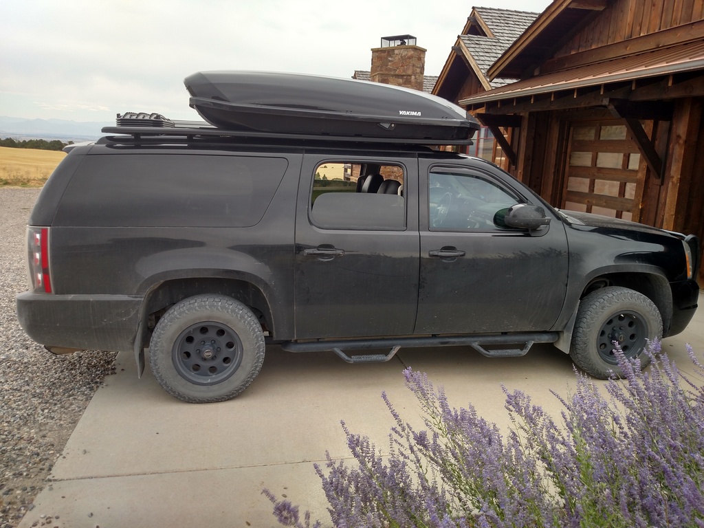

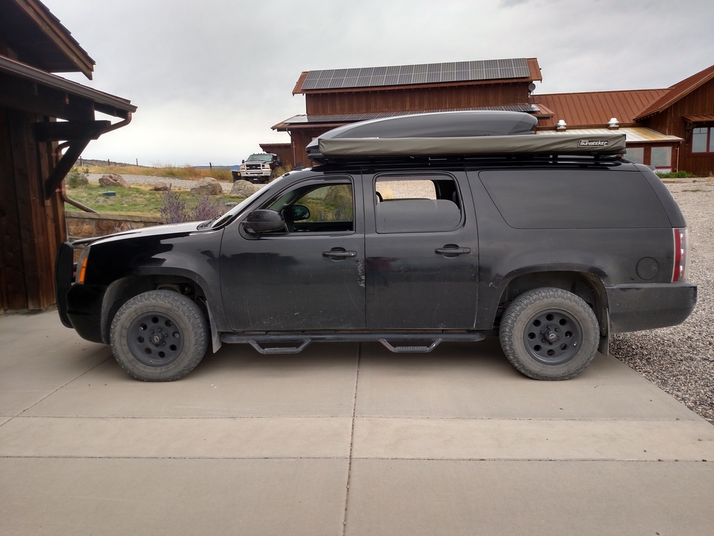

I have a 2012 Yukon xl Denali w z55 auto ride...
I added CCM 2.5" front and 1" rear to level... (Original shocks front and rear)
The back sagged so I added another 1" to the rear (2" total)
Looks much better...
I currently have 265/70/17 hankook Dynamo E rated... I need e rated because I drive 10 miles of high speed gravel round trip to my house... Anything less than E rated punctures tires...
Next tire replacement I will move up to 295/70/17 or 315/70/17.. Not sure if the 315 will fit
