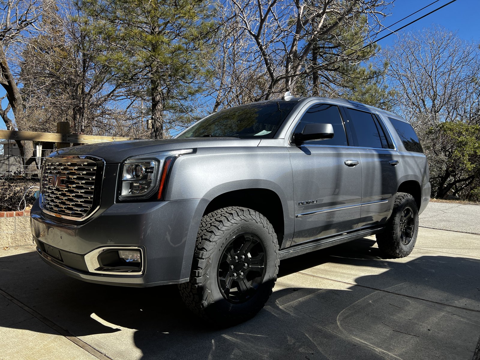

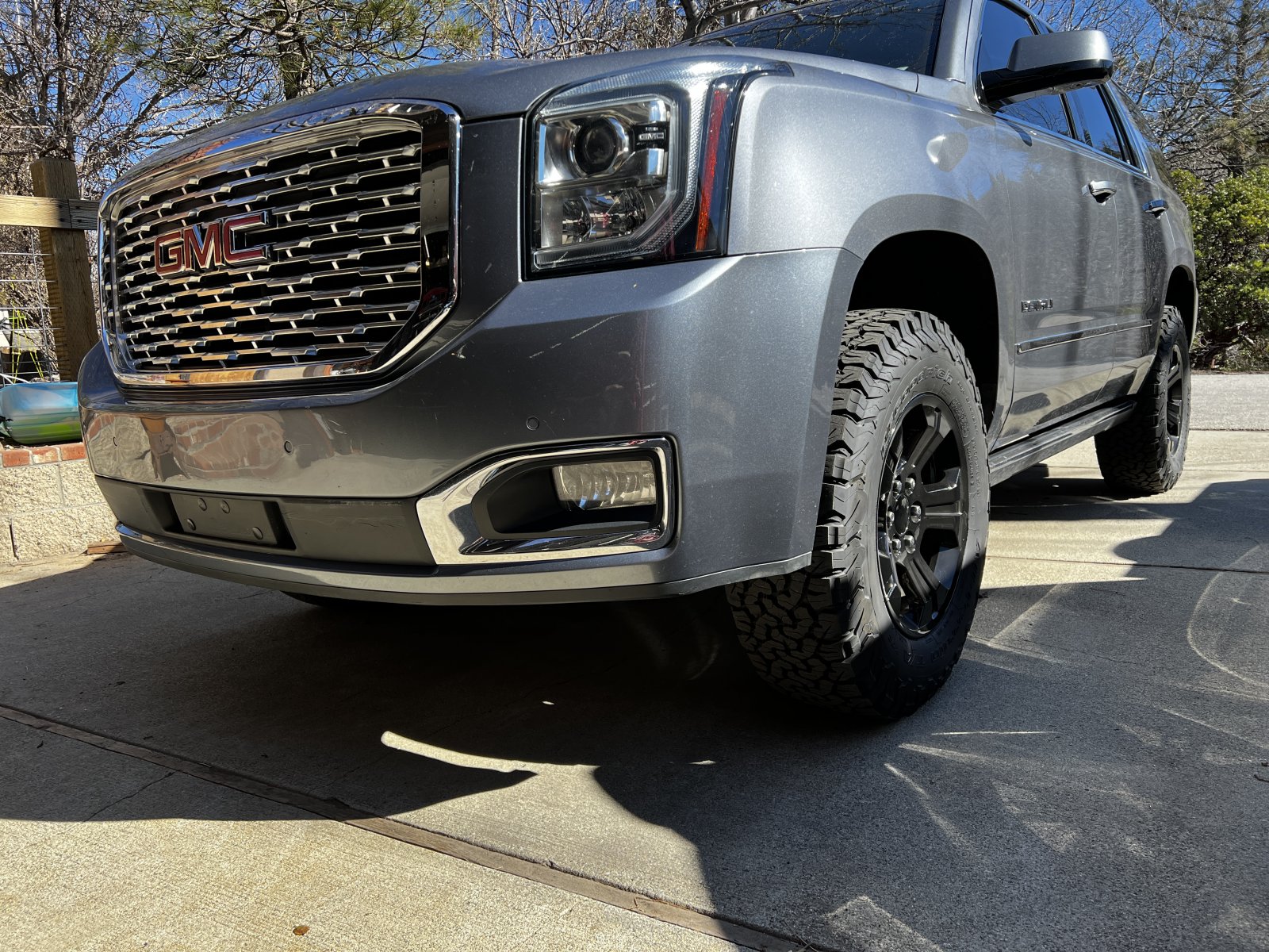

Trimmed the valance this morning. Now it has 15” from ground to bumper
