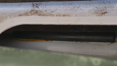

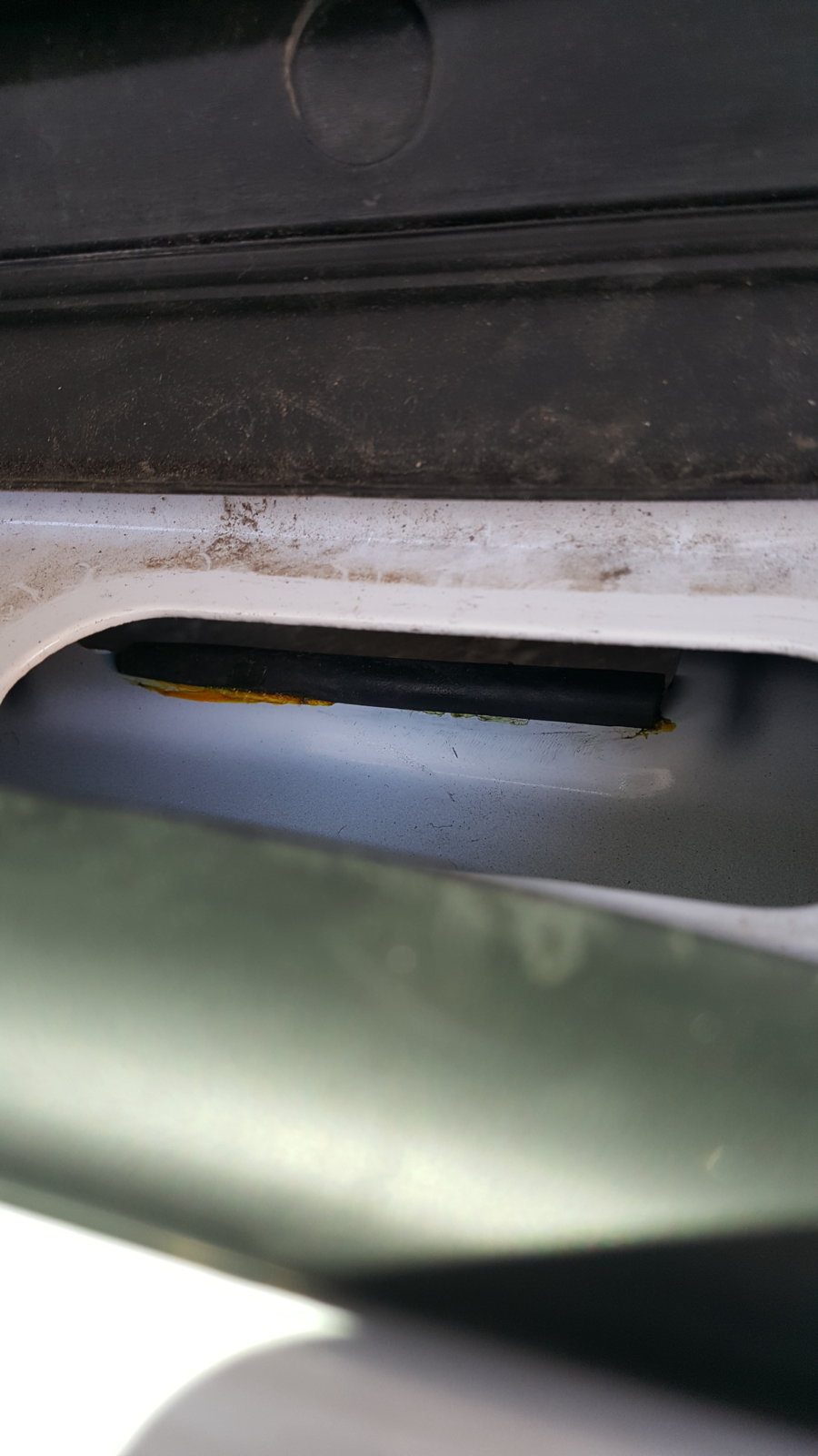

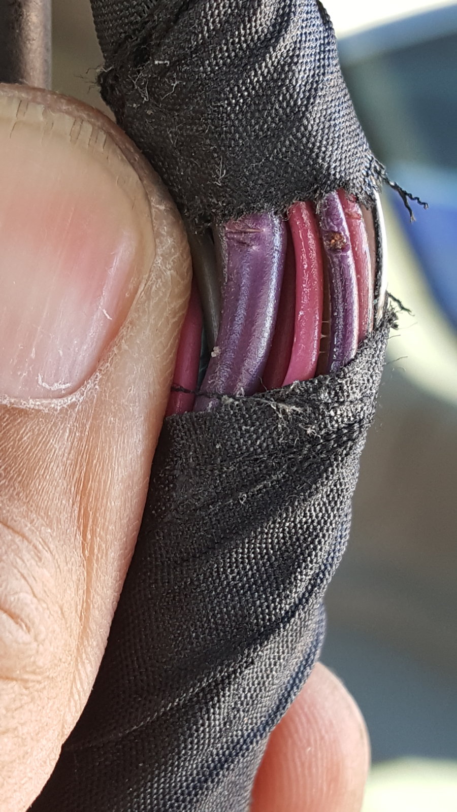

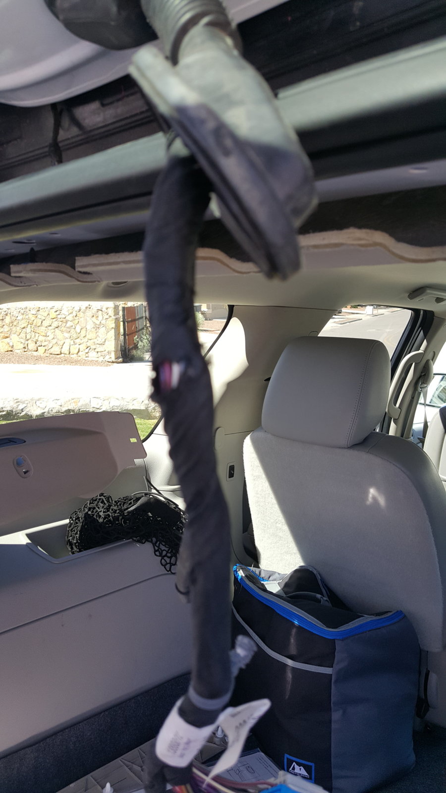

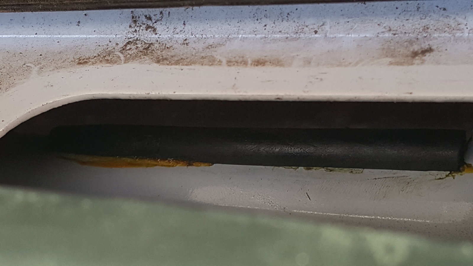

I have a 2013 Yukon. I think you should look at the wiring harness as it comes from the top of the liftgate and enters the body of the truck. I had a short as a result of the wires' sheathing being cut by the access holes above the headliner as the wire harness passes through it. The short in my harness caused my door locks to unlock and lock as I drove down the raod. At night when I set my alarm, the doorlocks would unlock and the alarm would go off . I took it to the dealer since I thought it was a BCM problem.

The dealer added windshield washer hose over the metal to avoid being cut again. I added the convoluted tubing over the harness for added protection.
