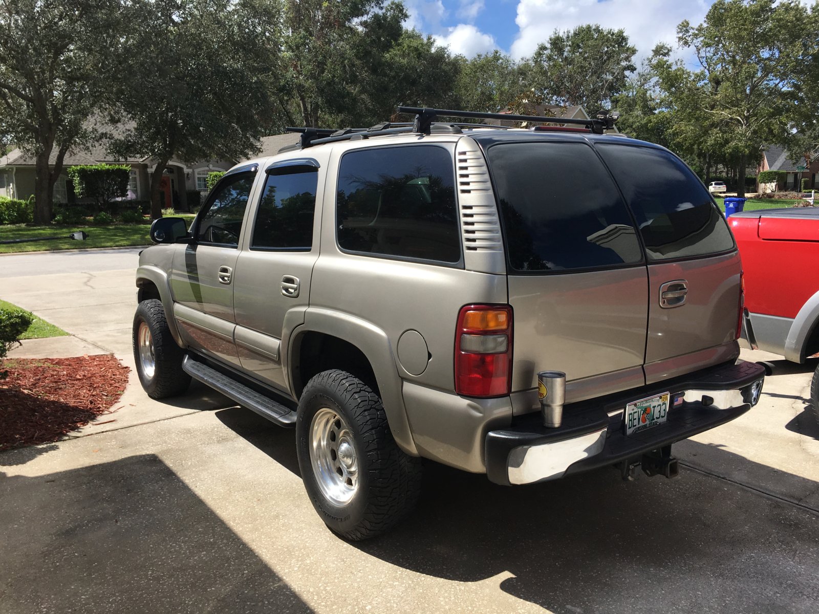

That’s awesome! If you can get some pictures with oem rims that would be great. I have a set of factory 17’s and if I can run the Amazon’s spindles with no spacers I would be very happy . So your not using any spacers for the rims at all?
southboundchicken
Mar 13, 2012
333
12
Jacksonville fl.
18B09037-23CE-42A1-82AD-F93E5C7F3419.jpeg No spacers, it looks good but would look better with a wider track.... decided to buy new rims for my pick up and moved my 17x9 centerlines over to the hoe... next week I’m getting 305-65-17 bfg all terrains
