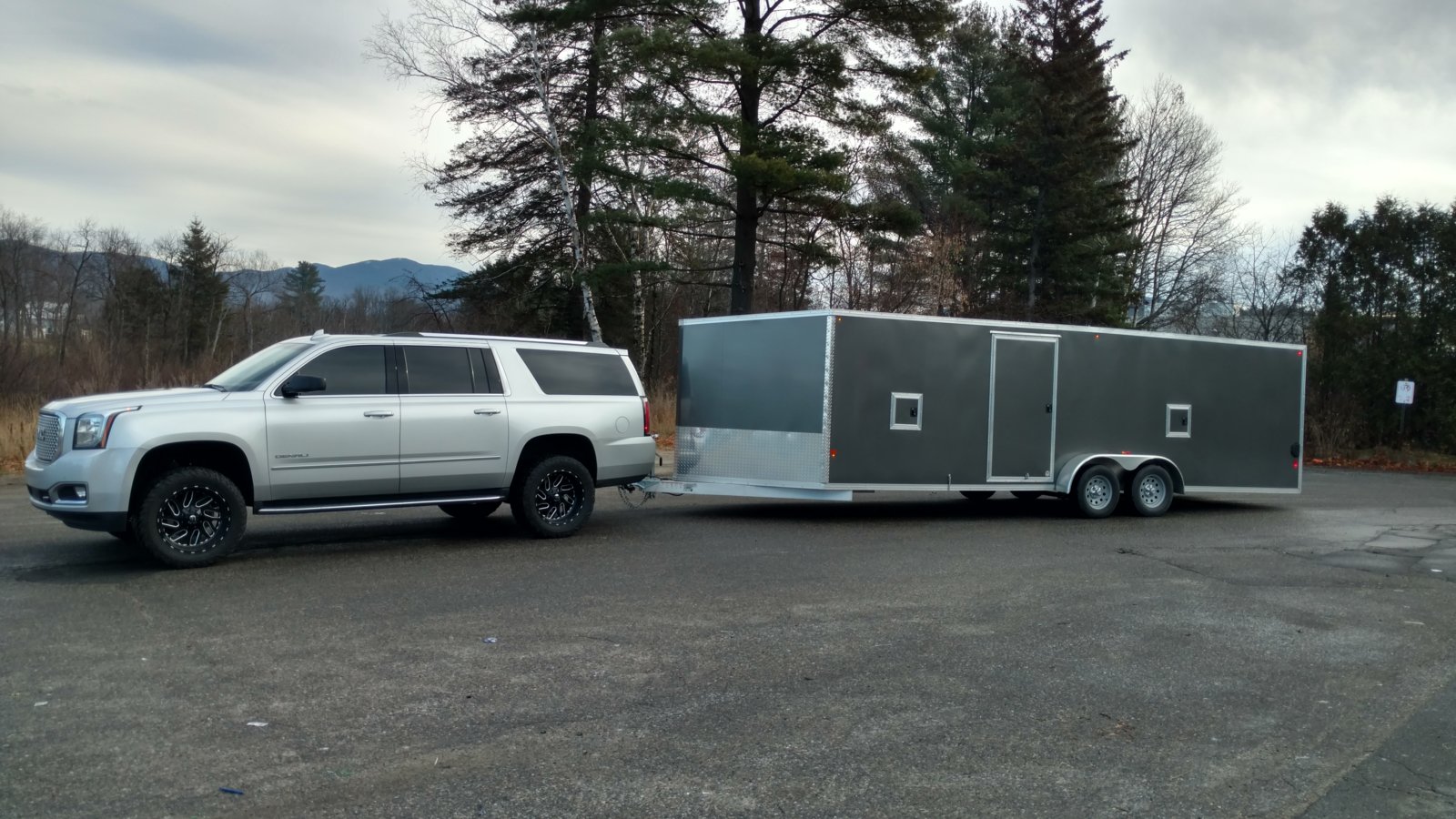

Fabtech 4" basic kit with an additional 1/2" up front, and Magnetic ride brackets, rear sits 1.5" higher, but dead level with a trailer. 201x10's with 33x12.5.IMG_20170723_214514.jpg IMG_20171125_100930311_HDR.jpg
