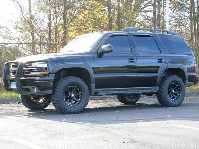

AquinoSteven
Key and Spacer Guru
May 12, 2009
946
Clinton, NJ
to fit 33s your gonna need keys and spacers. Ford F150 keys will give you 2-2.5"s. Spacers range anywhere from 1 to 3"s. I would go with a 1.5" spacer.
Ford keys
1.5" Spacer
